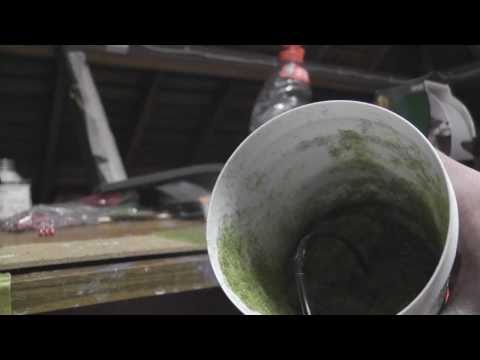

    hello all came across this when looking for long static grass,
    must have one , as alot off us make dio,s and use what ever we can for grass, be it fur painted, paint brush cut down and drill holes to pock in, or just pain flat grass
    Now hear is my question,s :P
    the one show is a electric fly swatter, from the US ?, that mite not be abled to obtain else were ?
    this way is a guy in the UK who made one but dose not wont to give up the info on how too ?
    the 1st way is the easy way to do, but as said would work better with an AC adopter ?
    I guess that dose take the place off the batters so would be wired to each side off the batter wires,
    but how would you scratch build one without the fly swatter ops: ?
    we must have some of you lads who are good and know about electronics who can say what is needed and how to put it together, as i think i would be off great use to most off use,
    as we real need for about 6mm grass or longer
    any help most welcome and appreciated,

            Cant watch the second video. Makes me sea sick. Serious dude if you are going to do a video to put on You tube, use a tripod....
            And I just sprinkle it on PVA ... Now I know why my grass always looks down trodden.
