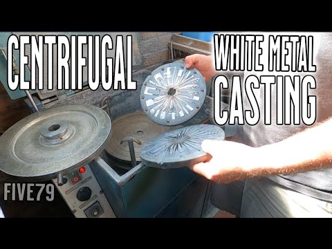

      White metal is lead free these days and has been for a good couple of decades. The model soldier market (probably the largest user of white metal castings these days) has been geared that way for a long time now, and this is no different. One of the reasons is that in countries like the US it’s illegal to sell castings with lead content, so if you want a wider market you have to comply with the laws in your target countries.
      White metal moulds are made of hard rubber and are used in centrifugal casting machines. These track links will be made in exactly the same way. The moulds wear quite quickly and are regularly replaced by recasting using a set of masters. It is old technology, but it is still viable and does not need replacing with 3D printing unless the commercial costs drive the change. New products may well be 3D printed though as the design and manufact processes are much closer integrated these days.
      This shows the process…
      One of the questions most often asked regarding the manufacturing of our kits is how the metal detail parts are made. So I thought we could show you a brief step by step of how it's done. The process itself is called spin casting, where a rubber mold is spun at high speed while hot liquid metal is poured into it, using a spin caster machine.First you need some metal and it needs to be melted into liquid form to about 700 degrees; this is done with a gas or electric melting pot. The metal used is a tin alloy. The pot is always kept full to help maintain temperature. Then you need a mold of the items you are casting. In this case it's an HO scale set of fire safety parts that includes a fire call box, standpipe valve and alarm bell. These are often seen on the walls of industrial buildings. Making the original master parts is another story which we can get to another time. But to make the vulcanized rubber molds, you need multiples of the original master pattern, usually machined in brass. You first make a mold that produces one, use that mold to make a few dozen production masters, then those go into a production mold - so there are a few steps missing here. But we'll jump right to using the finished production mold.The mold is 9
      It’s a very low waste process. All the sprue gate material can be put back in the melting pot and used for the next pour, so only the metal used for the actual part is sold on.
      Here’s one in action…..
