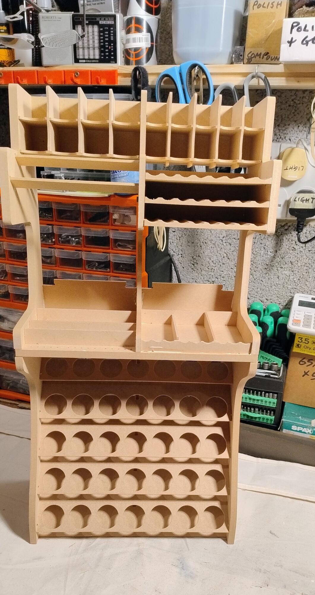

    As you may have read on other threads I have just bought a new model making/paint stand.
    From Bucasso, looks nice, well priced, well made, etc, etc.
    Its one of these, comes in two section, top half and bottom half, they can be joined or separate....see pic:
Name:	Bucasso Model MAKERS CABINET OCT24 (5).jpg
    It arrived, I assembled it, I painted it, all good. At no point had I yet put any of my paints in it.
    After letting the paint dry and harden overnight in my garage, I transferred the paint stand upstairs to my study/model making area.
    Looked lovely on my desk.....
    Then I proceeded to place one of my jars of paint into the stand, erm, no! They won't bloody fit!
    Stupidly I should have double checked before ordering, on the Bucasso website it states the stand has paint stand holes of 1.26 inches.
    Did I actually do the conversion to metric? erm, no. Its actually about 32mm.
    What diameter are the paints I have? (Tamiya, MG, Ammo, Vellejo), erm, all 35mm, therefore the diameter of the holes would need to be 36mm min.
    I was bloody fuming, as their website does state suitable for Tamiya, etc. But, this company is actually based in Hong Kong, so I'm now wondering if they have / use different sized paints, pots, tins, etc?
    I have contacted them to see if they can do anything, (maybe supply a new paint stand with correct holes), but it may be a case of Caveat Emptor, and my own stupid bloody fault for not checking properly.
    I've glued and painted the unit now, so I can't really send it back either, again my own fault for being too eager.
    I may as a last resort be able to drill the holes bigger, but TBH the gap between each hole is already quite narrow, so not sure if theres actually enough room to go larger?
    The silver lining (sort of) is that the top section is fine and I can still use that to store tool files, paint brushes, pliers, knifes, glue, etc, etc.
    So what have we learnt? well, when ordering online, especially from some far flung nation, check the bloody measurements!!!!
    Gutted really, as apart from the hole diameter size, its a really nice unit...oh well you live and learn.... 😂

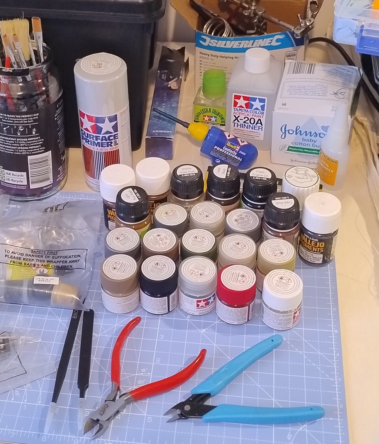

                  I have Tamiya jars/bottles, and AMMO, Vellajo and MG washes, panel liners, etc. See old pic below, although I have a few more than this now, about 25-28 so far. These are all 35mm in diameter, so none of them fit the 32mm holes.

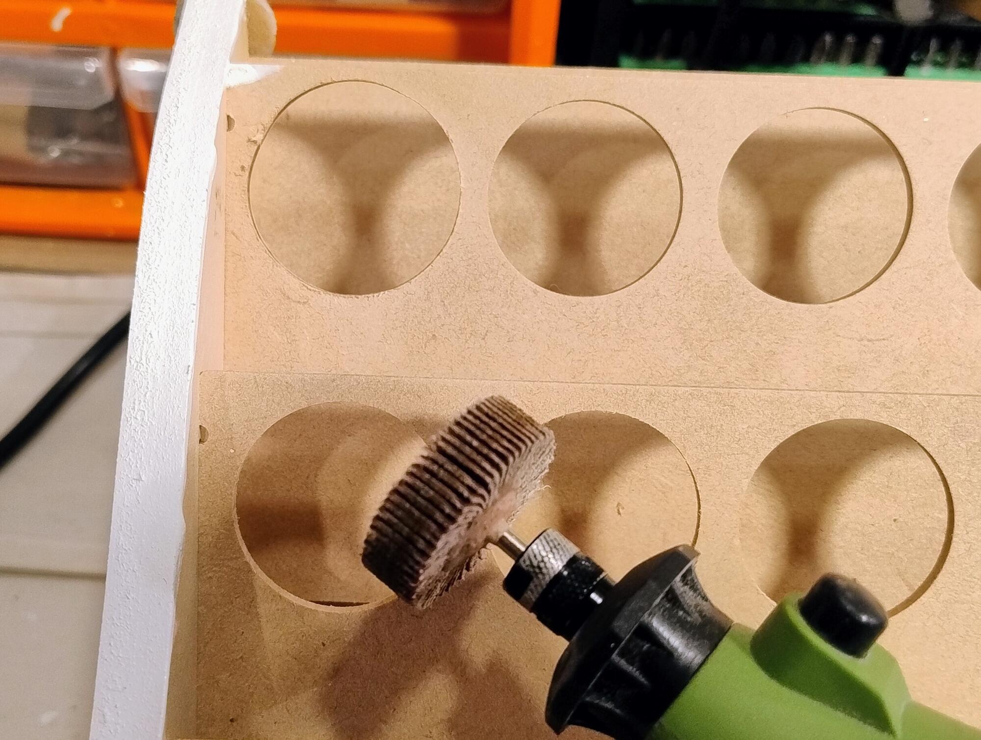

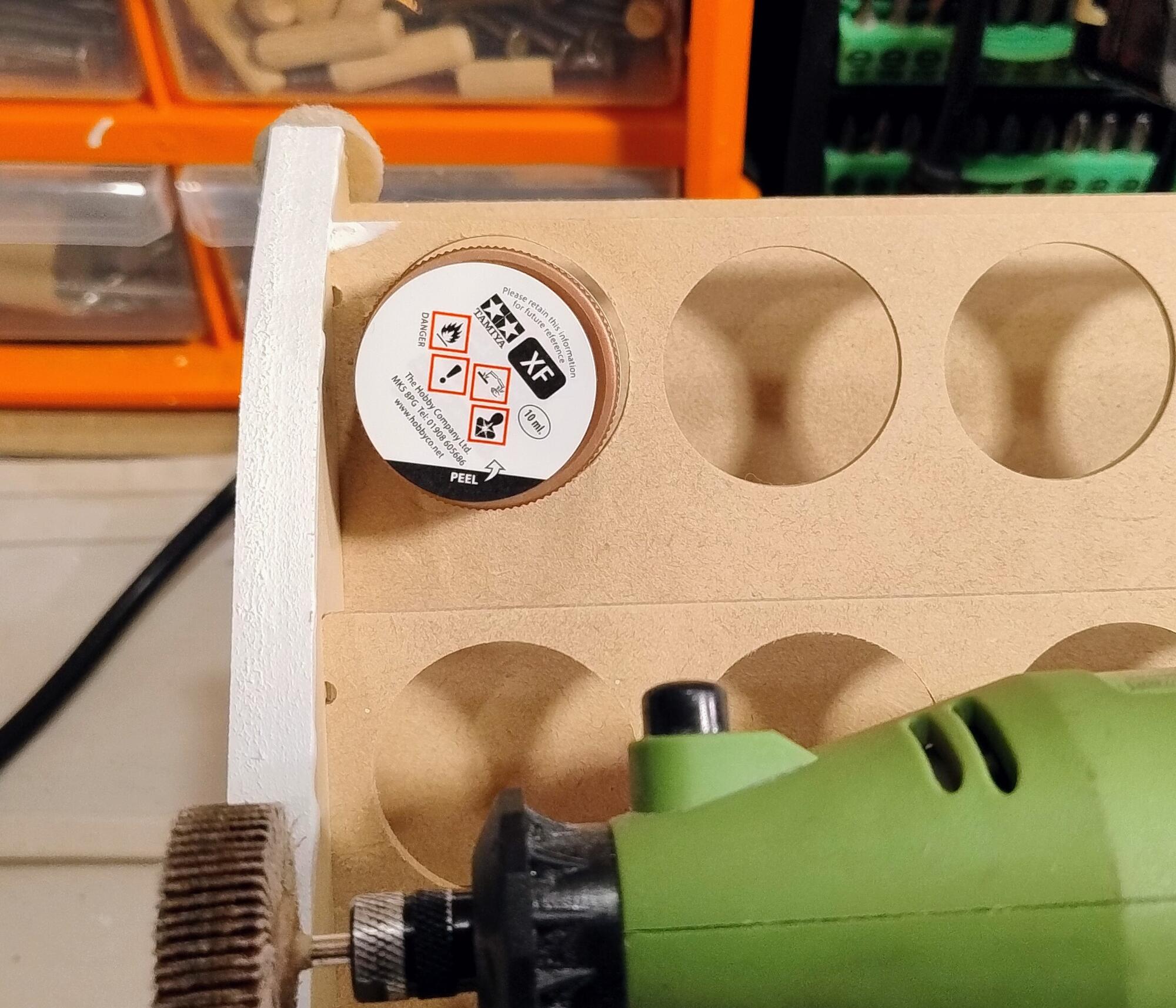

                        Fixed It!!!! 😀👍
                        So had a look to see if I could make these holes any bigger.
                        Looked at using a Forster Bit, but as the holes are already cut, nowt for the centre of the Forster bit to centre on, so no good.
                        Looked at a hole saw bit, but again, needs summit to centre on, tried it anyway and it just wobbled about like a wobbly thing from Wobblesville!
                        Lastly, thought, hmm, I must have some sort of sanding disc small enough, and looked in my Dremel (clone) box, and yes, theres was a sanding bit just the right size.
                        So I could therefore effectively ream out each hole to the correct size.
Name:	New holes in paint stand (2).jpg
Name:	New holes in paint stand (1).jpg
                        See very short Youtube clip - see linky
                        Took about 30-45 seconds to do each one, but there were 35 of them, and I had to keep stopping every now and again to let the dremel cool off as it was getting bloody hot!
                        So now have a paint stand that actually holds my paint, but.... I've already filled it up, so will need another one very soon! 😂😂😂

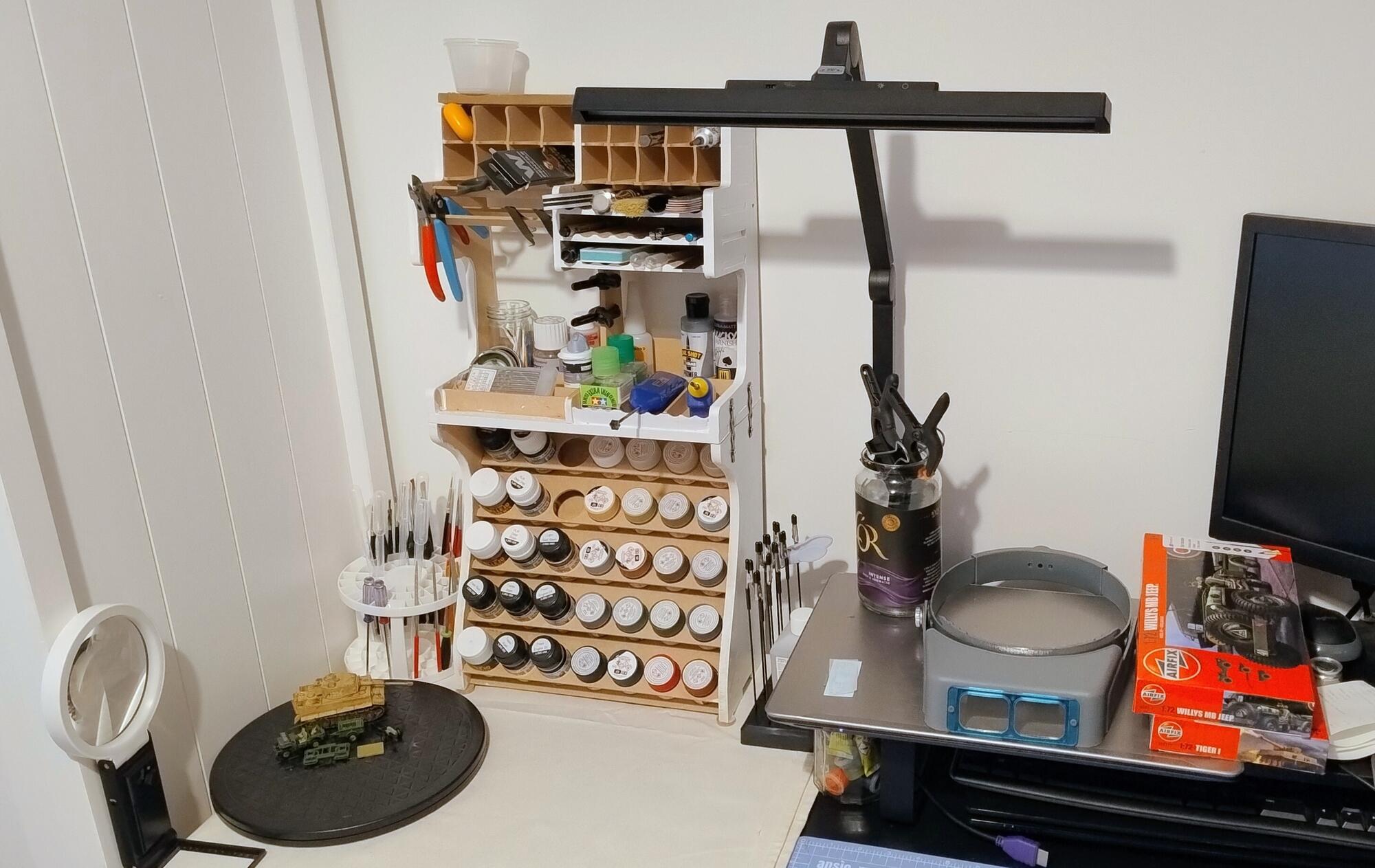

                        Result....
Name:	Bucasso paint stand on desk oct24 (1).jpg
