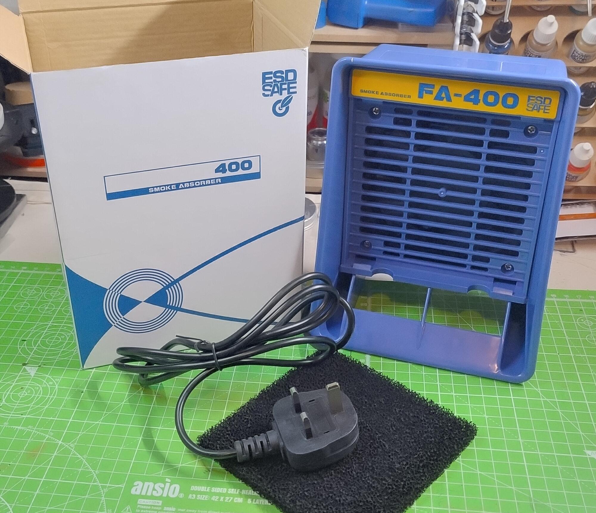

So got mine form eBay, at just a smidge under £20. This one was listed as a smoke/fume absorber.
Postage was free. Seller was "mobitools-uk". NB: I have no affiliation with the seller.
It was delivered in a few days and well packed. It comes with one small foam pad cut to size, and it also came with a UK fitted plug, always a bonus!

The lead is not very long, but long enough, eg: 1.5m (150cm or 1500mm or 58" ish). The size of the actual unit is approx 8" x 6.5" (or 200mm x 170mm).

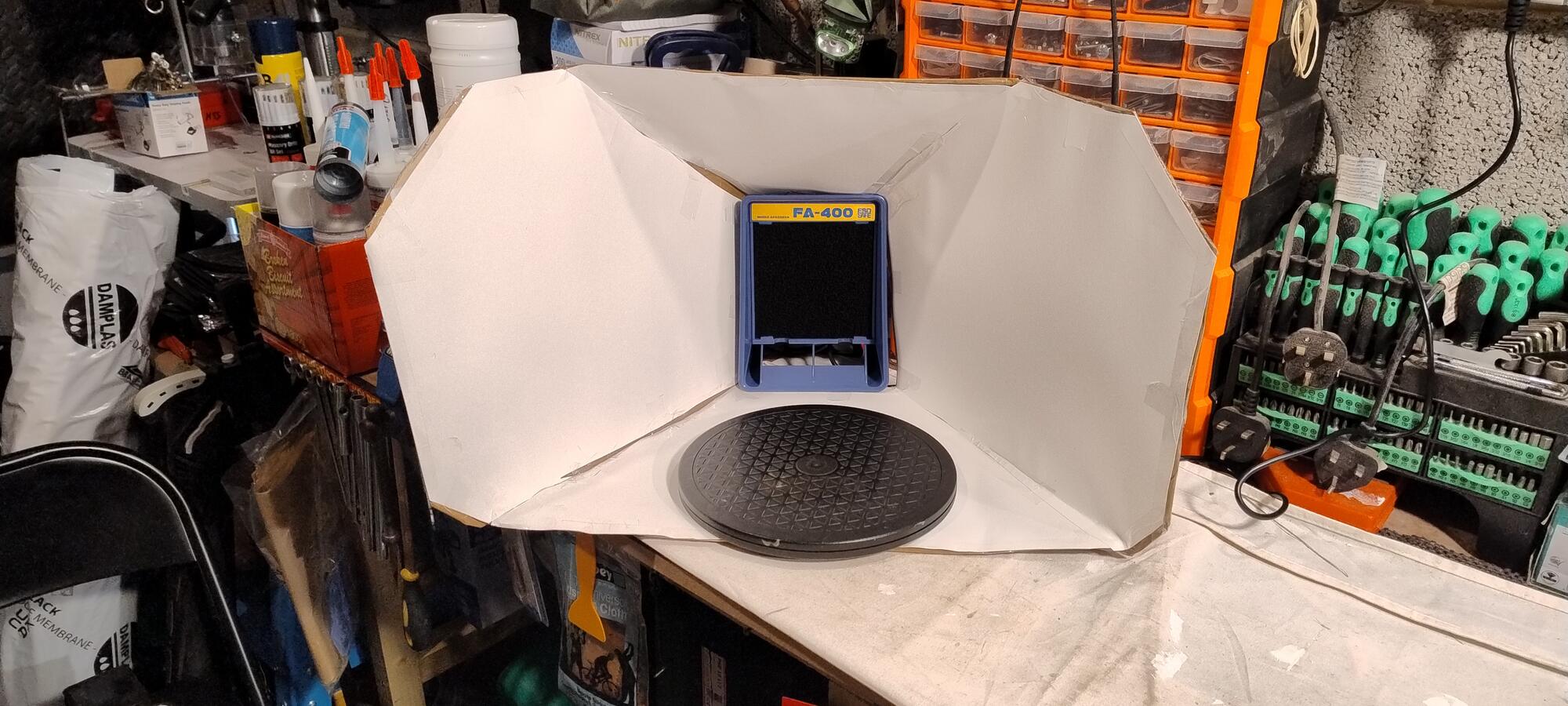

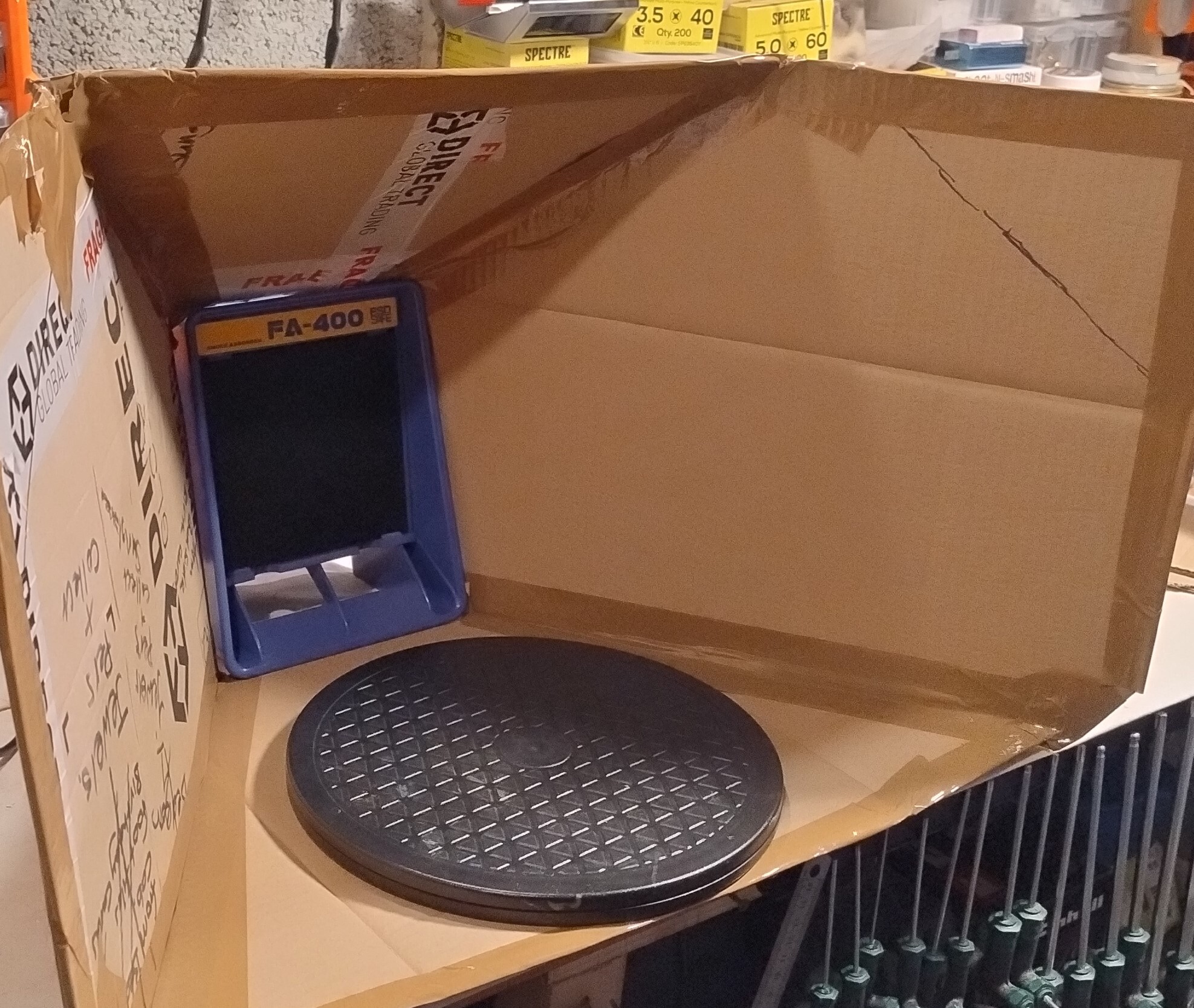

My plan is to use this in the garage as and when its needed. So also wanted to build a surround for it, with my little model turntable in front of it, so items being sprayed can easily be rotated. Being a tight wad I thought I'd just make my own out of rigid carboard. Here's what I ended up with on the mk1 version....
I then thought I'd line it with old lining paper, as I happen to have a spare roll laying around, and can easily be replaced when necessary, so then the mk2 is now like this....
So, whats it like to use? Well did a little bit of rattle can spraying today, and when switched on the fan is reasonably quiet, and seems to have some good suction. If you hold a piece of tissue paper in front of it, it gets stuck to the front, indicating a reasonable amount of air flow being pulled through the filter by the fan. (NB: there is a simple flick switch to the rear of the unit.)
The unit seemed to get rid of most of the fumes, smells, etc and after a few minutes spraying the front of the foam filter was showing paint staining, again indicating that the paint fumes, etc are being drawn into the filter. I have also purchased some replacement foam, the type used in kitchen extractors, eg: carbon activated.
