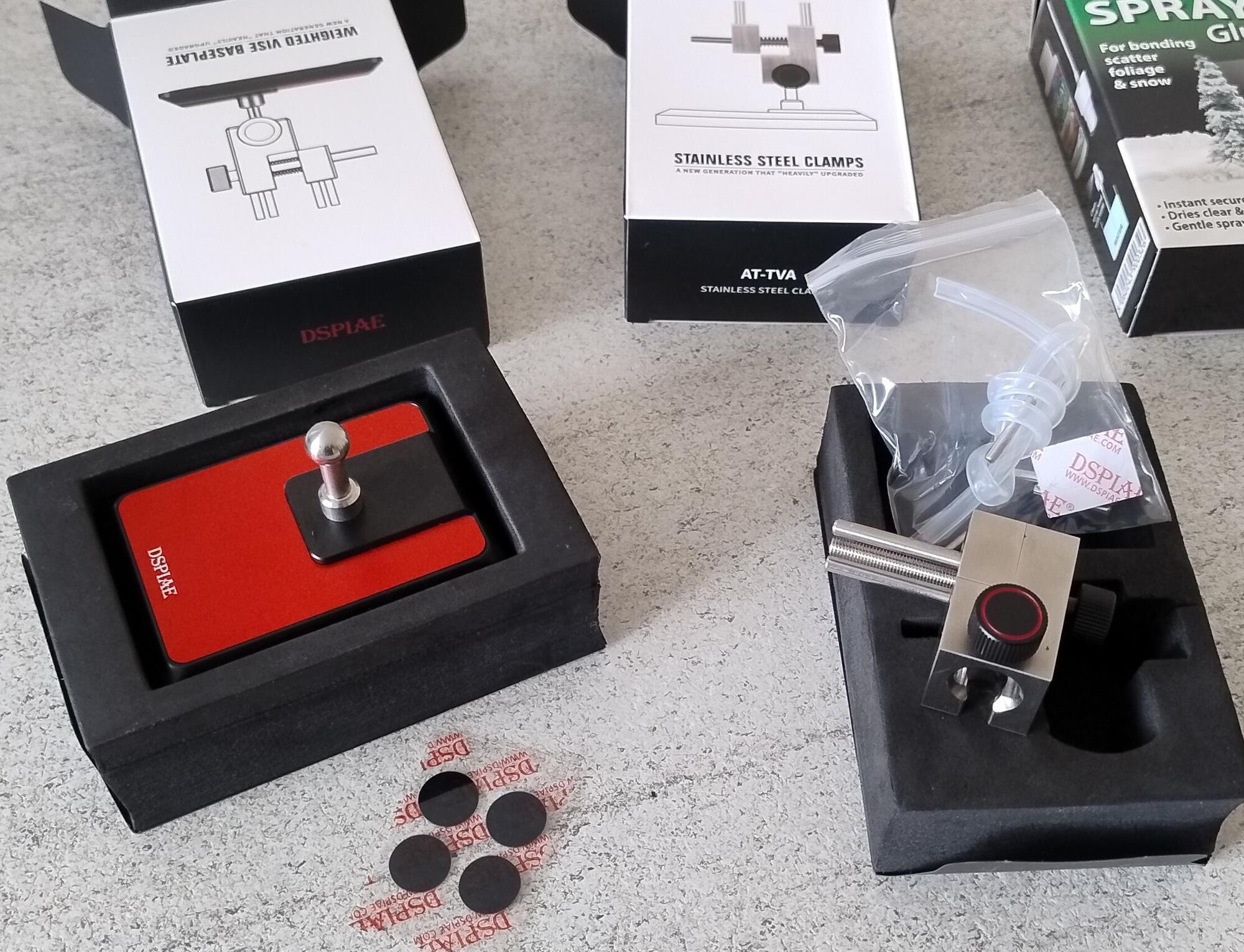

    It comes in two boxes, the main clamp/vice and the base.
    Click image for larger version  Name:	DSPiae vice june25 review  (23).jpg Views:	0 Size:	410.6 KB ID:	1261943
    Although its small, the base is surprisingly heavy and feels very stable. It comes with four little rubber feet which can be stuck on the underside of the base, so will not slip around.
    Click image for larger version  Name:	DSPiae vice june25 review  (18).jpg Views:	0 Size:	575.9 KB ID:	1261950
    The packaging is very nice, thick card boxes, nicely printed, and lush thick packing material inside the boxes.

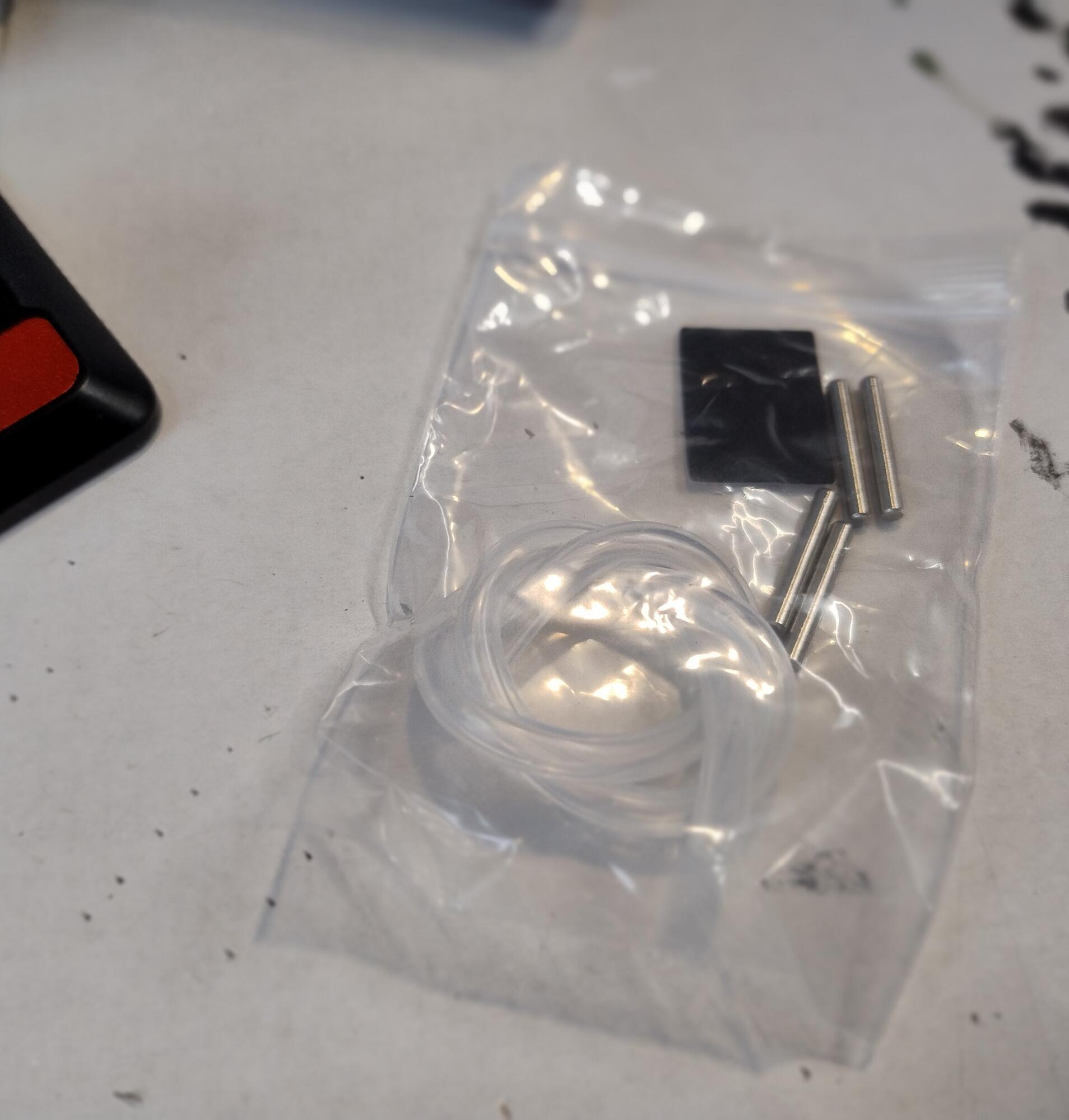

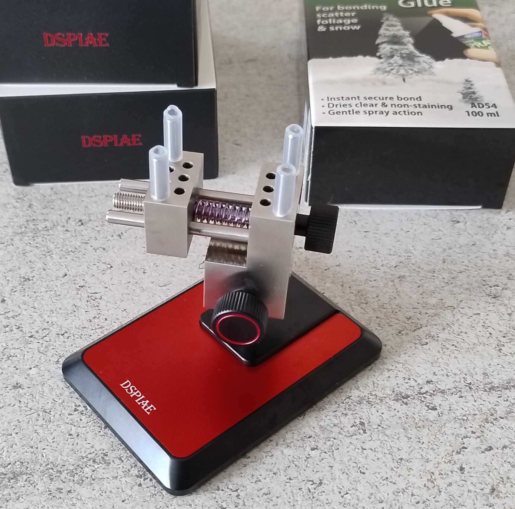

    Assembly is a breeze, just clamp together the base and the main body, via one round/ball joint. Insert as many pins as you require, (it comes with eight pins). and cover the pins with the (included) soft rubber tubing, so nothing gets scratched whilst its being held in the clamp.
    Click image for larger version  Name:	DSPiae vice june25 review  (3).jpg Views:	0 Size:	155.8 KB ID:	1261944
    You get more than enough tubing to cover all eight pins and a bit more as spare. I decided to just use four pins, as I feel that will cover most circumstances.

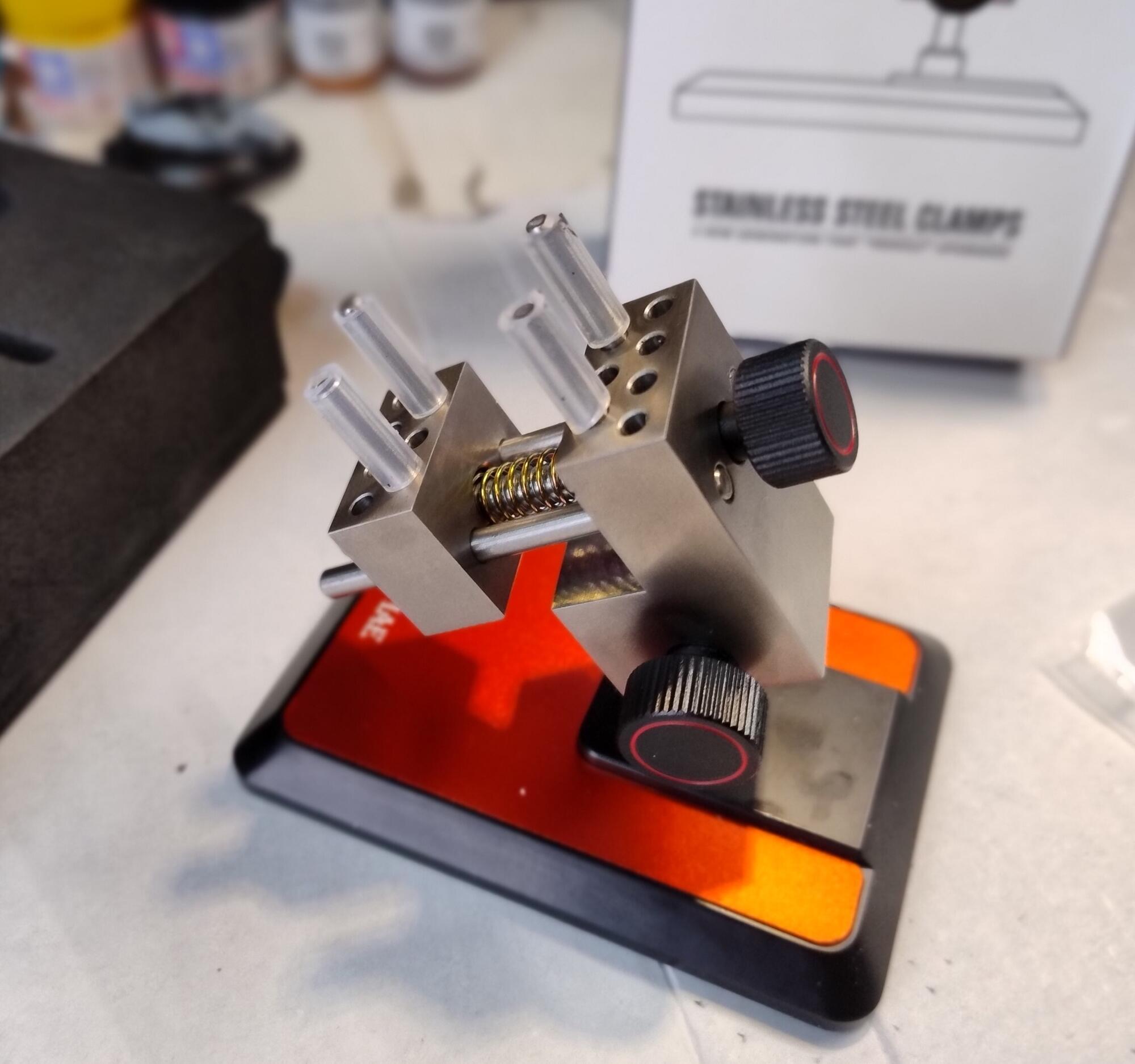

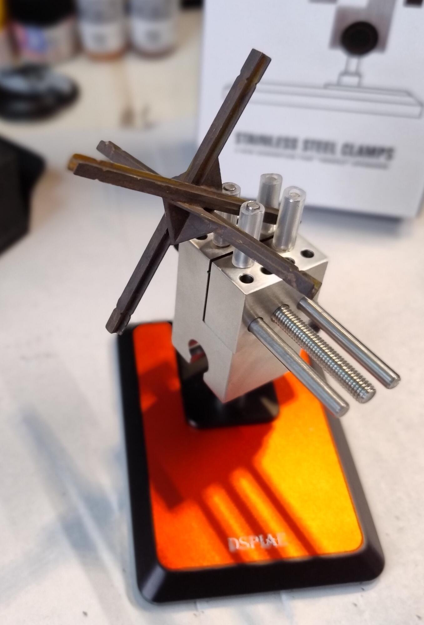

    The main clamp body is heavy stainless steel and again, feels well made, nice tight tolerances, it does not feel slack or loose at all. You can rotate the main body through pretty much any angle, up, down, left, right, on an oblique or diagonal angle then lock it in place via the thumb turn screw.
    The two clamps can be closed or opened by the other thumb turn knob/screw. The open/close mechanism is very smooth, not notchy, and the main threaded bar and two guide bars all seem well made.
    Click image for larger version  Name:	DSPiae vice june25 review  (7).jpg Views:	0 Size:	171.2 KB ID:	1261945

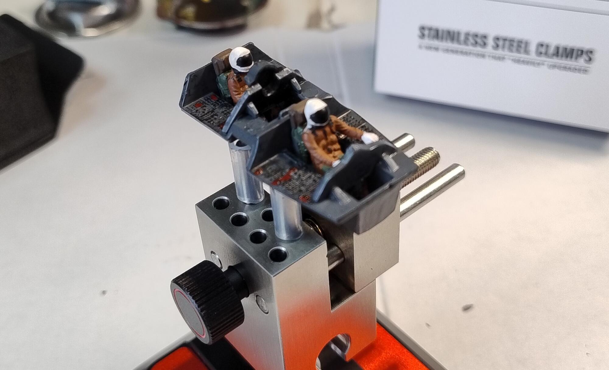

    I have now used this clamp for few things, holding for gluing and painting and it seems to work well, the main negative is its small size so would not be suitable for larger models, or assemblies, but its ideal for the small scale stuff IMHO.

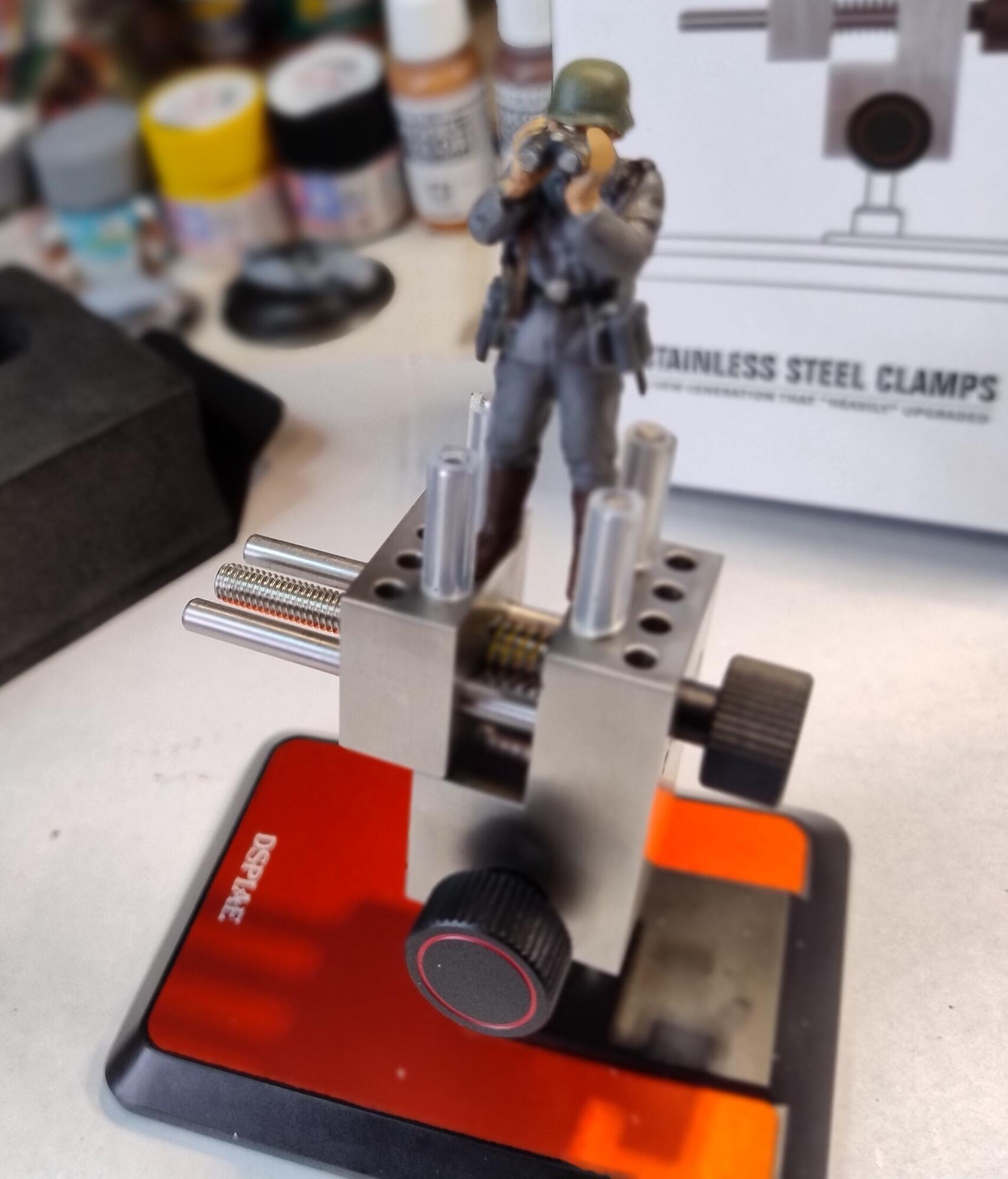

    Heres a few examples of small stuff being clamped....
    A 1:35 scale German figure....
    Click image for larger version  Name:	DSPiae vice june25 review  (11).jpg Views:	0 Size:	170.9 KB ID:	1261946

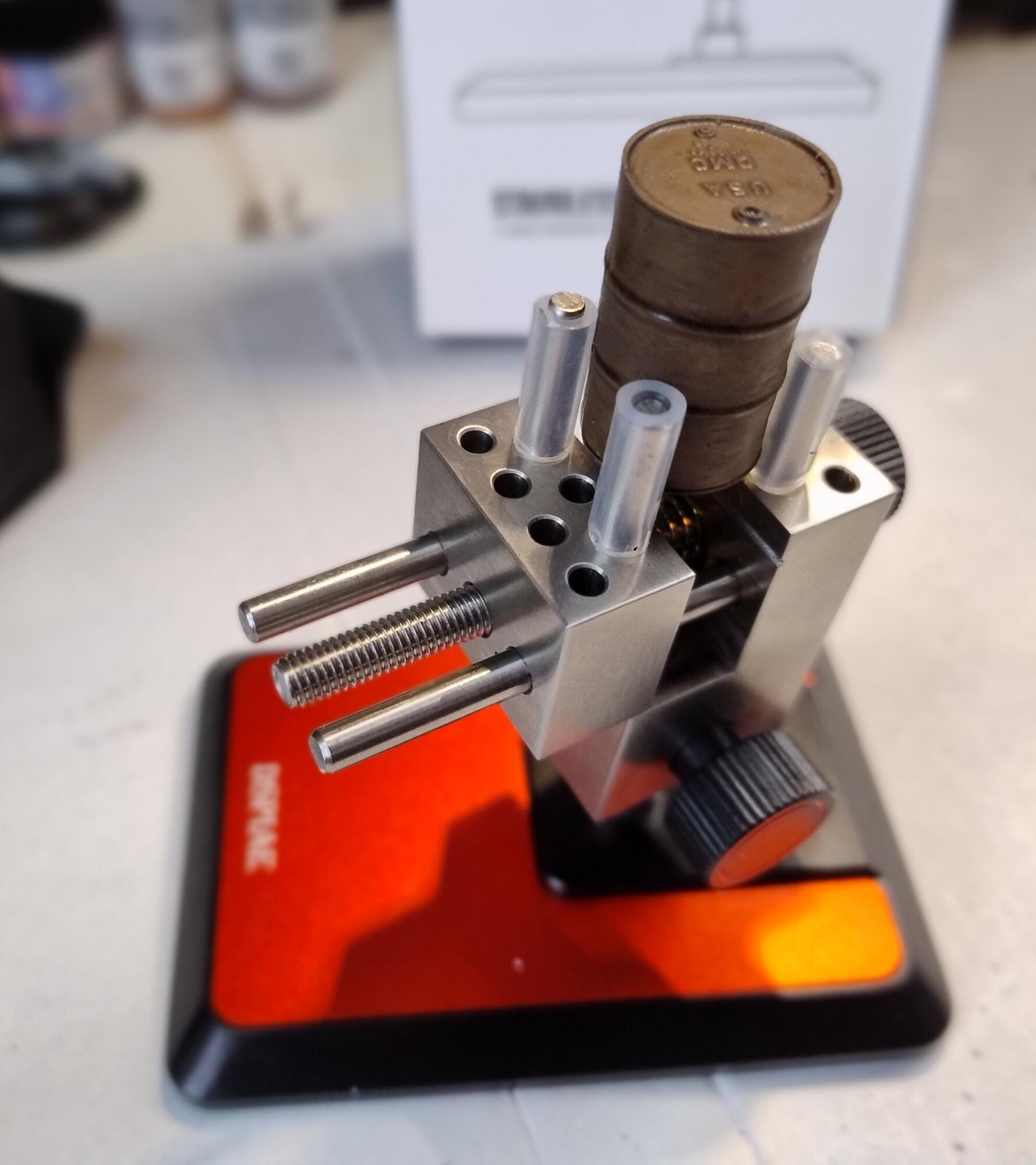

    A 1:35 scale oil drum....
    Click image for larger version  Name:	DSPiae vice june25 review  (12).jpg Views:	0 Size:	163.9 KB ID:	1261947

    A 1:72 scale plane cockpit assembly....
    Click image for larger version  Name:	DSPiae vice june25 review  (17).jpg Views:	0 Size:	177.3 KB ID:	1261949

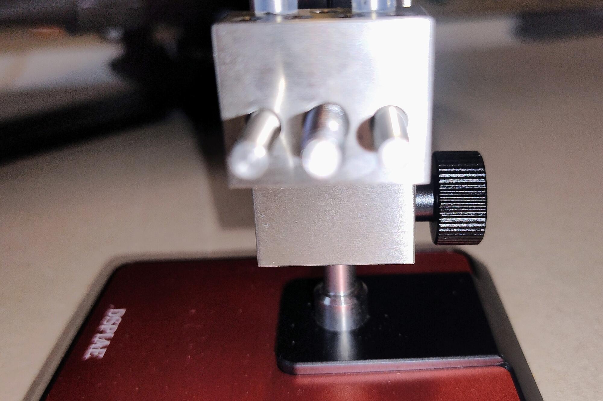

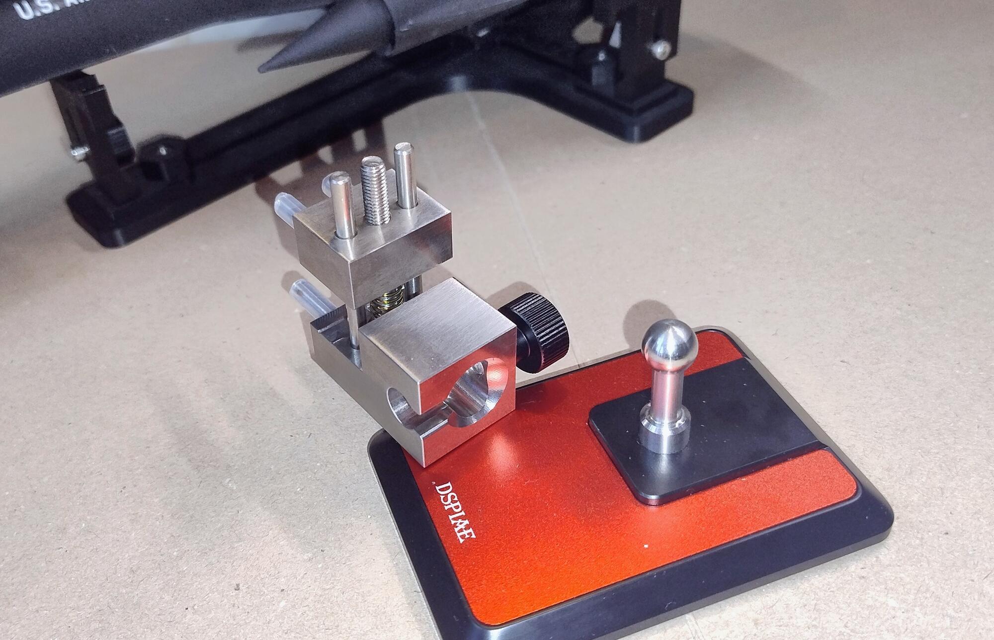

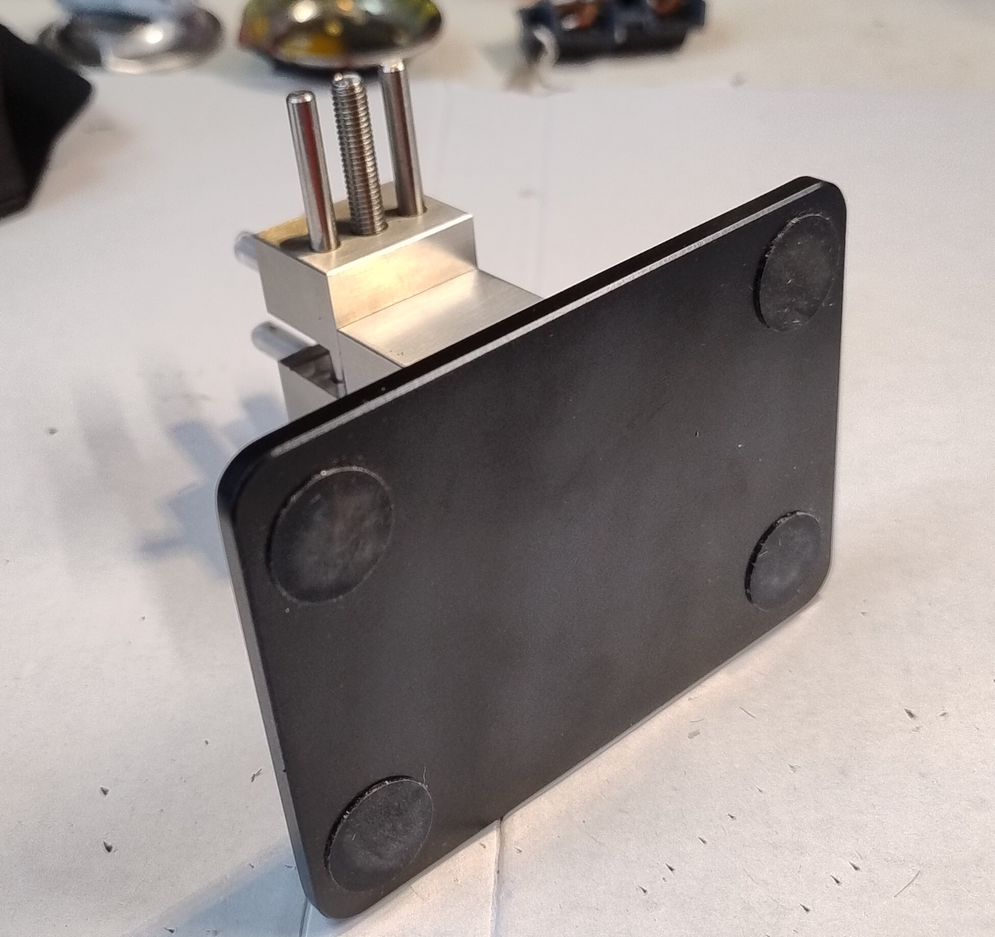

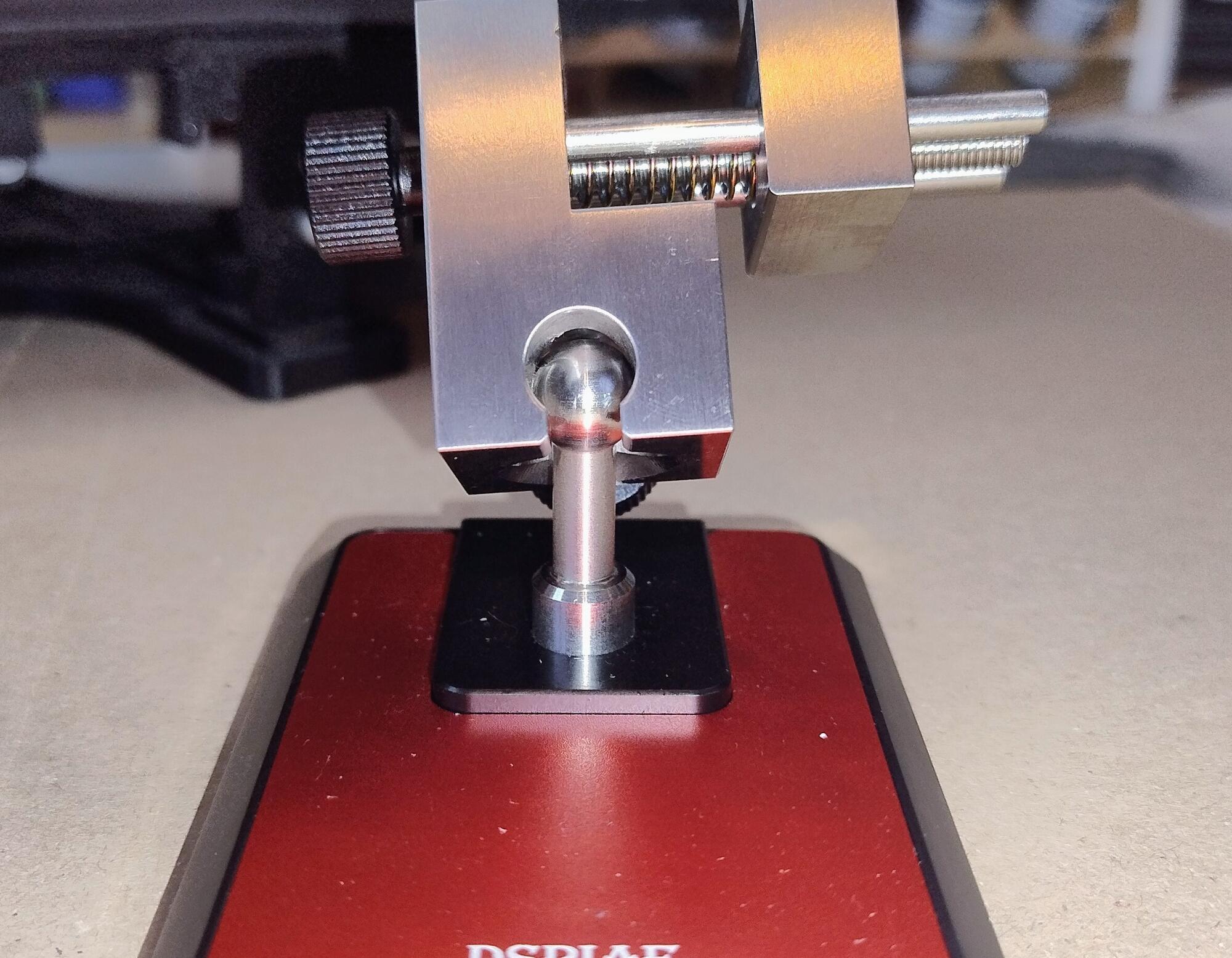

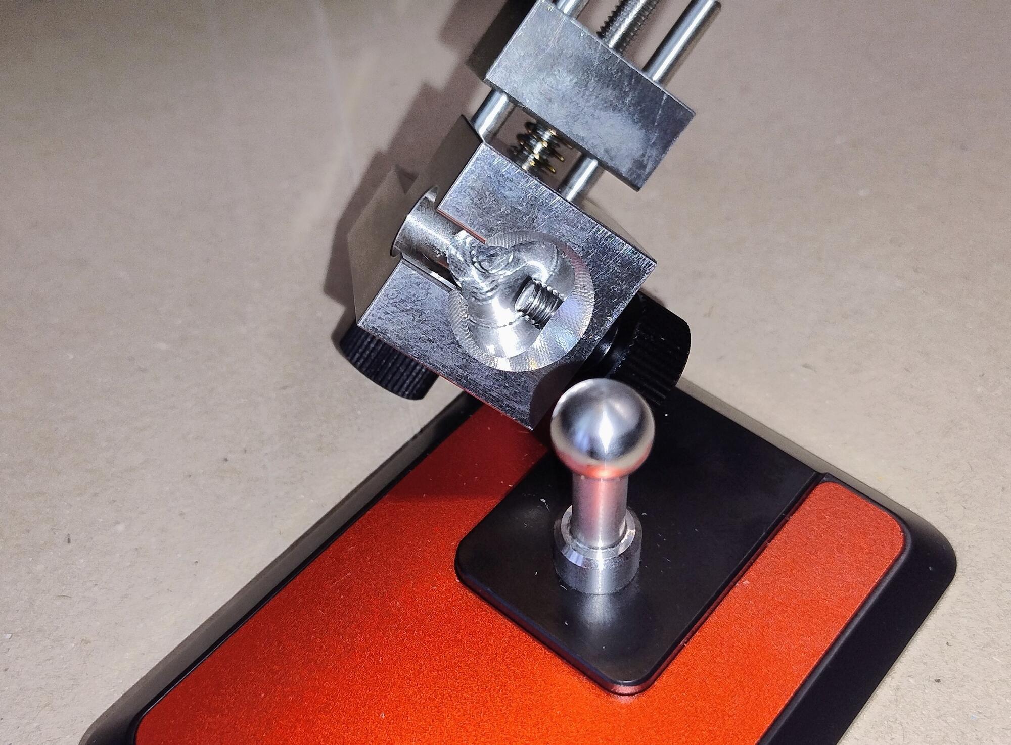

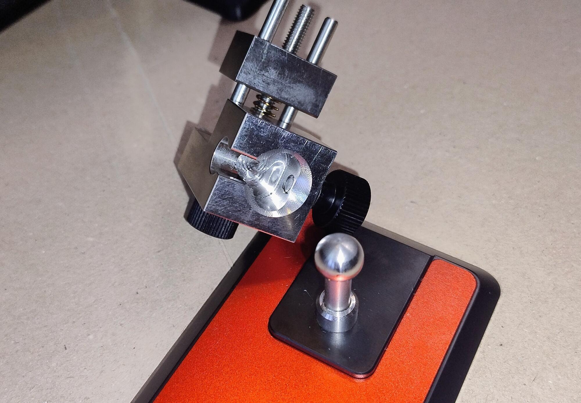

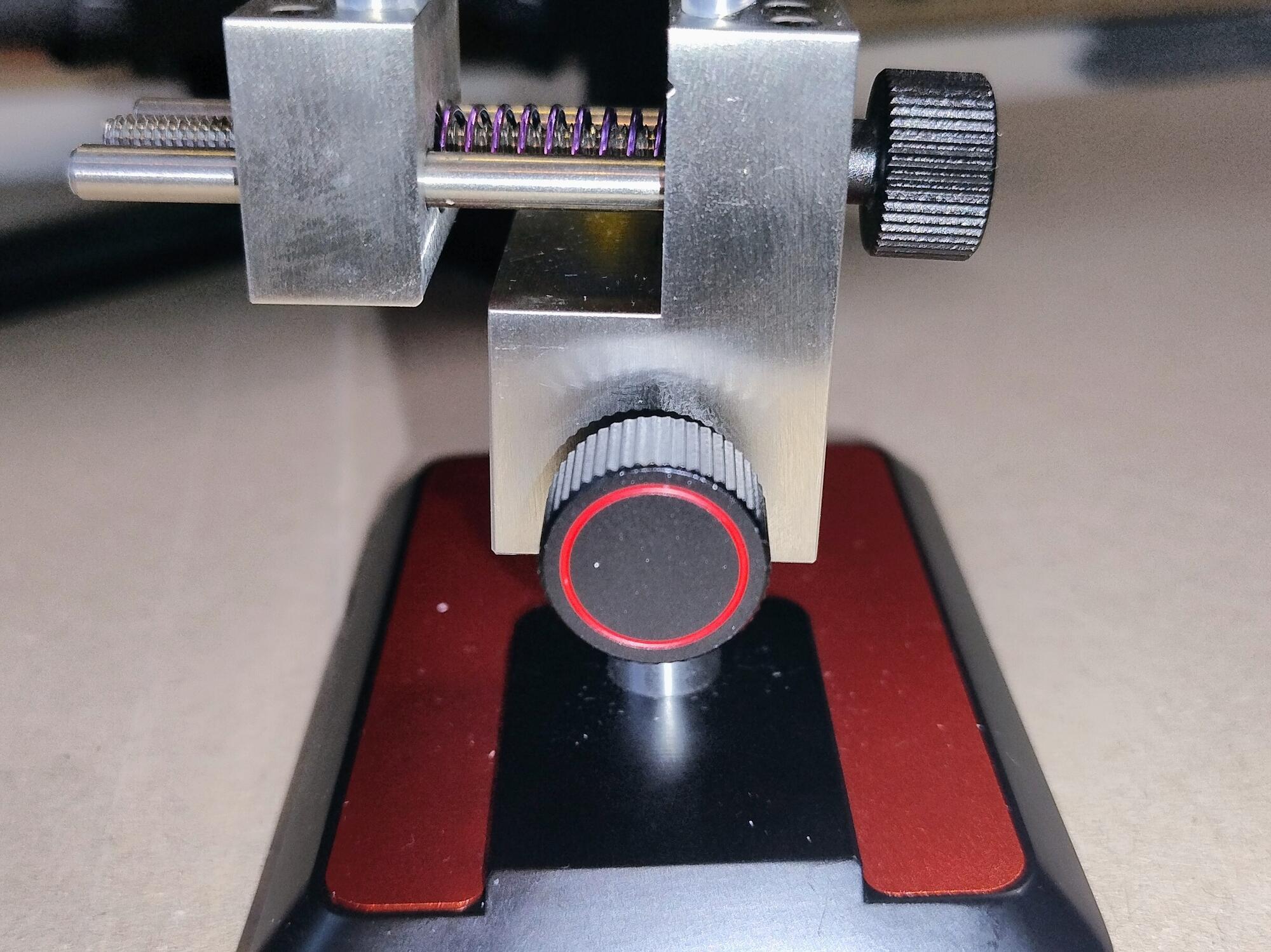

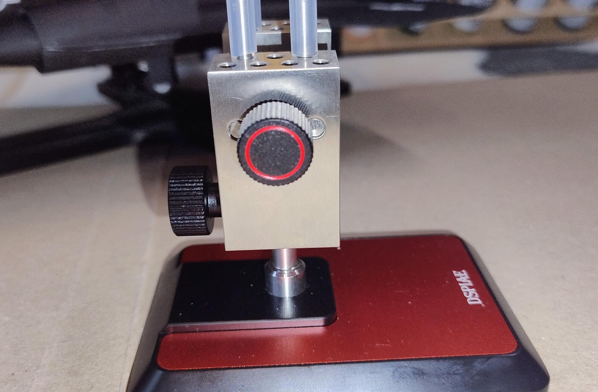

          Nice review Peter.

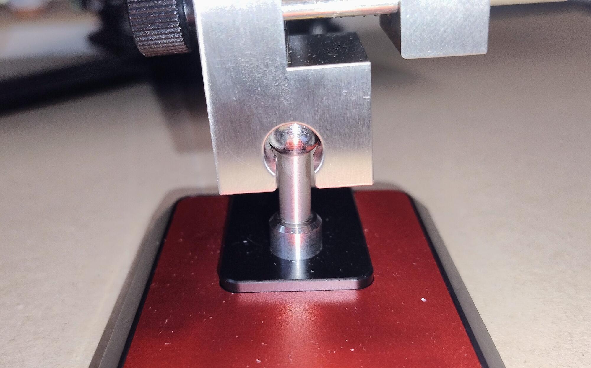

          I'm intrigued how the ball is retained in the socket?? It looks like it slides in from the side, and is locked by the thumbscrew on the opposite side, but how does tightening the thumbscrew not push the ball out?
          Any chance of a pic of the underside of the clamping part?

          • pjgtech
            pjgtech commented
            Editing a comment
            Pics attached, hope they are useful, cheers.... 8-)
        • pjgtech
          • Dec 2023
          • 1168
          • Peter
          • Swale Kent UK
          Extra pics of the base and the ball joint for Bob as requested above, its a nice tight fit and holds well once tightened.
          I tried to get every angle and every side view in and also the thumb turn screw wound fully out and wound fully in, cheers.

          • Mr Bowcat
            • Dec 2016
            • 4657
            • Bob
            • London
            Thank Peter, that makes sense now.
