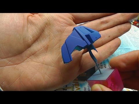

                Good video here .
                Might be of some help. Note the use of the Flow improver as well .
                John.
