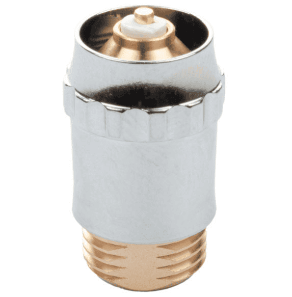

                      Originally posted by BarryW
                      4/ If you still have some money left you might want to get an in-line ‘fine pressure control’ at the ‘business end’ as an easy way to adjust pressure. I set the compressor pressure at the highest level I might need and then adjust it up and down, as needed, at the airbrush end.
                      Any chance of a link Barry, please?
                              Hi Pete. SMS doesn’t have any that I can find listed but I found this on line.
                              Get greater control on your spraying with this genuine Harder & Steenbeck FPC Valve 12654 suitable for use with Evolution CR plus, Infinity CR plus and Evolution AL plus. For this and all your Harder & Steenbeck spare parts come to Graphics Direct
                              They are also called MAC valves incidentally. They do the same thing.
