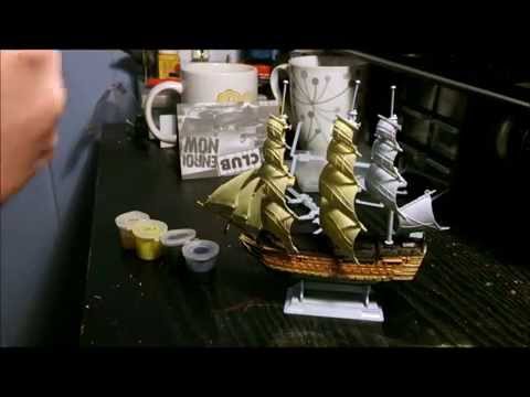

      Cheap as chips! I also found this YouTube clip which summed up my first experience, but I persevered and managed to get better results:

        It maybe me...but I get the impression that he hates the kit in the vid...

          That was on one the very first ever kits produced by Airfix....1950's era. I am not sure why the Aussie in the video is so upset with it, the kit is what you can expect from that era. Not worth bothering with those 'starter paints' either...
