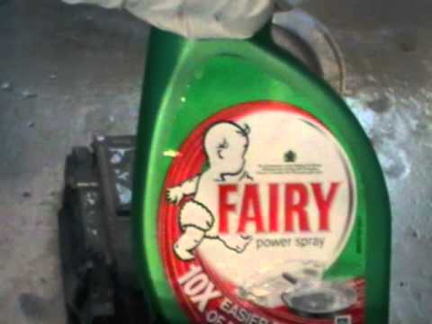

                            here's a video clip I've used fairy power spray to good effect in the past
