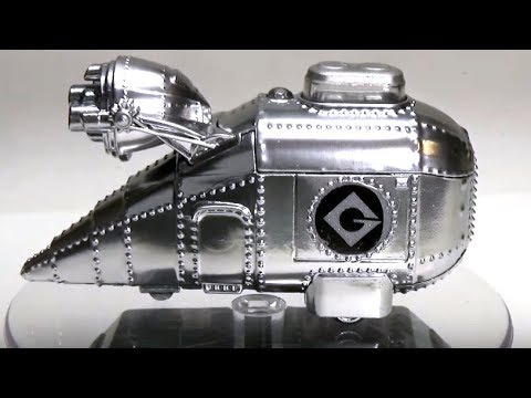

                              Originally posted by Bortig the Viking
                              Thanks for the replies, will give Alclad 2 a try although have Molotow pens, any ideas how to thin it for spraying, does it need it ?
                              This might help.
