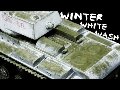

                              Having a look around the net and found this by 'Martin Kovac..aka Night Shift', it's well worth a watch..
