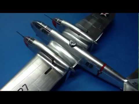

                  And now for something completely different. It's a Polish called 'Rub and buff'. I used it on a B36, it works really well. That might actually be Rub 'n' buff.
