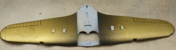

So, here's the gold undercoat, which I'll be masking with the letters, either tape or transfers, then over that with the blue. In about a week's time to ensure it's dry!
The fuselage took three coats before it got good coverage, and the wing is on the third now, too. Okay, so, this IS the first time I've used AK stuff, and I may not be great with my airbrush, but this stuff takes a bugger of a long time to dry. Also, the big blotch on the starboard wing is where the paint came off, when it rested against some paper TWO HOURS after it was sprayed. My mistake but... And, as can be seen from the port wing bump additions, that stuff REALLY doesn't like bare plastic

Three days and the gold is STILL tacky. Although that does seem to be making the masking stick well

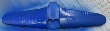

And so on with the blue. This might just work. When complete there'll be an all over gloss coverage. As hoped, the gold base does punch up the blue a little
So, here's a successful test
The tail surfaces have no gold, and they've come out fine. Likewise the u/c doors. The right hand u/c doors are to test masking , and that's not looking too bad.

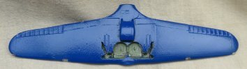

Not a real disaster but a minor hiccup. I haven't done the wings underside blue just yet, but I thought I'd gloss it up first
And wouldn't you know it, the wing flipped over and the varnish took the blue off when it touched down. Nothing that can't be solved with a touch-up. But Humbrol acrylic spray makes Vallejo airbrush colours liquid again. useful to know

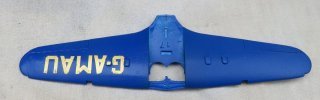

Needs a bit of touch-up, but hasn't turned out too bad, all things considered. Starboard side is better than port. The portside 'U' needs work as it was originally a transfer as mask
