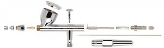

Hey guys.. I just scored an Iwata HP-CS off eBay sealed in box.. Magnificent tool.
I broke the airbrush down, to lube etc…
The airbrush may have sat for awhile, but it did arrive sealed and new… All the parts broke down perfect without issue but the airbrush nozzle is stuck inside the body of the airbrush… Im sure it’s dry and has been there for awhile. I can back the needle out no issues but any recommendations how I can get the nozzle out without damaging it??
Many thanks!!!
-Ed
Which bit specifically are you asking about?
Nozzles I1103 and I1403 should come off without tools, but for I0808 you need the tool supplied with the airbrush.

This one my friend I hope the image transmits…

Jakko is right. The nozzle needs a little spanner which is supplied with the airbrush. It fits on the opposite flat sides and unscrews.
There's a difference in the nozzle between the HP-C plus and the HP-CS which Ed has. The spray nozzle in my HP-CS gets stuck, it is a compression fit and they are very tight. It is not necessarily due to a dirty airbrush, it is a common 'fault' with the HP-CS. Don't force it off, or you risk damaging the nozzle tip.
If you are concerned about it, do an internet search for "HP-CS nozzle stuck". There are solutions that do not involve poking things into the nozzle or forcing it, namely the use of lacquer thinner and/or boiling water.
Thanks fellas. I brushed some Iwata Lube around the base, then gently pried/pulled it with soft jaw pliers. It came out relatively easy, no damage whatsoever. Good score for me finding this for $105.00!!

Just remember to put a spot of lube on the taper fit when reassembling it and you won’t get that problem again. Don’t over tighten the nut on the securing cover either. I only ever do mine up hand tight, rarely using the supplied spanner.
