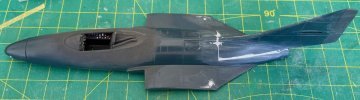

Many shaves later, I have done some more work on the Panther.
Overall painted Blue Angels Blue, using Model Master enamel:
The Panther then had a stall/spin crash a few days later. I removed it from the drying mount and my stick up the exhaust slid out. Repairs were done to the paint on the wingtips and nose, and the canopy was fixed back on, and paint touch ups done. Luckily enamel paint is tough.
