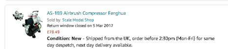

Bought mine ( as-189 ) on Amazon ( john's shop on amazon ) and it has been reliable from day one , presurises , stops , and when you start using the pressure it rebuilds it, never noticed it get very hot , though I tend to do 15 minutes at time max , and not spraying constantly.
