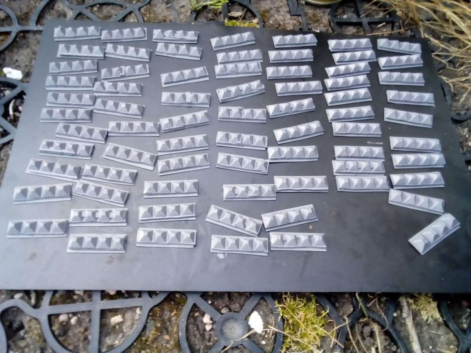

Step 1 - Cutting it up
I tried using my Dremel to cut it using a rotary blade but soon gave up. The plastic melted and roughed up. However reverting to a sharp, strong craft knife turned out to be the solution. The knife can be fairly easily pushed through with a bit of pressure.
The mat is essentially divided into 9. The 4 side sections were easiest. I cut large squares first, stripping the edging and supporting strips from underneath before cutting the board into strips 4 pyramids long.
There are hundreds of them. I stopped after I’d cut 73. That gives me about 9 feet of dragons teeth 1 wide or 4.5 feet doubled up.
I still have more than half the board left but the remaining bits require more cutting and the middle is just not usable.
I then used the knife to cut the top off the pyramids to square them off.

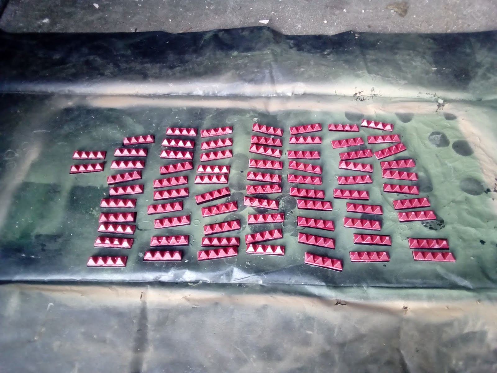

Step 2 - Basing and Undercoat
I superglued the strips onto bases each about 4cm long and about 1cm wide and then sprayed them with a base grey undercoat.

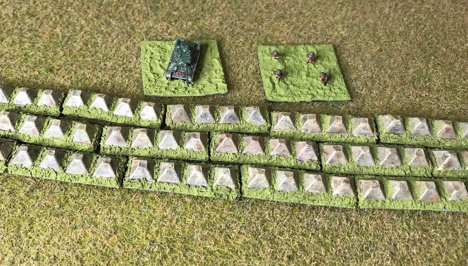

Step 3 - Painting
I tend to use Army Painter paints and inks, but any decent acrylic paint would work as well. Painting consisted of a first coat of Dark Tone ink wash, then a light dry brush of Desert Yellow followed by another lighter dry brush of Skeleton Bone. Finally a Soft Tone ink wash to finish it off.
Step 4 - Basing
I used Basetex for a quick finish which I could sculpt around the dragons teeth. And that’s it. Job done.
