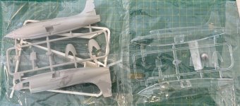

It comes with the option for clear fuselage halves, a stand, and weights if you are presenting it on the landing gear. Inside you would be able to see any section of the interior you wanted to leave umasked if you chose to use the clear sections. I'm going to have solid colour sides, and mount the model on the supplied stand, with the landing gear retracted.

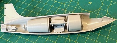

I fixed the internals in place, just to see how they would look. They'll never see the light of day again, just playing around. I think if you had the clear sections exposed, you might need to either paint where there are gaps, or add a lot of pipe detail.

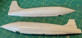

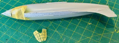

As I am doing my X-1 gear-up, I fitted the main gear doors closed. Which was a lot of work, as the mould is intended for landing gear down. The cockpit entry hatch is also fixed in place.

Today's mission was to sort out the fuselage, gear doors, and mask that complex canopy. I've since sanded and polished the seams.

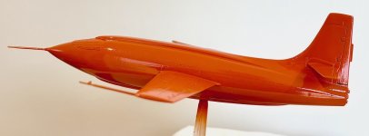

Assembly was relatively straight forward. A fair amount of filling and sanding was required at the wing and horizontal stab joins, mostly achieved with Vallejo acrylic filler. The X-1 was first primed with Mr Surfacer Grey, and after a few days drying, I have applied the gloss orange paint in two light coats. Once this is totally dry in a few days I will polish the paint, before masking and painting the canopy framing black. There won't be much more to paint after decal application, just the rocket motors and probes.
Looking very good joe , great paint finish. Cheers tony

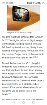

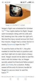

So this was chuck yeagers plane that he broke the sound barrier in...... His wifes name was glennis
As i remember from his autobio the night before he made the attempt he went out for a drink..... On a horse!..... Cos the base was in the desert..... On the way back the horse threw him and he broke a rib..... Knowing if he said anything they wouldnt let him fly and someone else would take his place he kept quiet....... Next day he struggles to lift his arm and cant shut the door on the plane so he confides in his crew chief who goes off and finds a broom..... Cuts off a 2 foot length and its long enough to work as a lever so yeager can pull the door shut with his good arm..... And the rest is history lol

I was almost right.... Must be 20 years since i read his memoirs lol
Thanks for that Paul, I did not know this part of the story. Different times!
