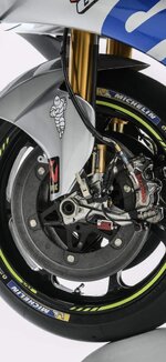

I've tried something a bit different with the brakes. Rather than going for the factory fresh look, I've tried using some oils to make them look like they've done a few laps.
It makes it look a bit more like the actual bike
