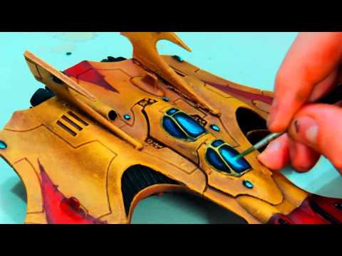

                        Depends if you want to see inside it really Andrzej. Personally I’d go with polished first and see what it looks like. If you want to paint it, try something like this…..
                        Much more interesting than a single colour.

                          #207
                          Thank you, Gentlemen! :smiling:
                          I think I will polish it, see what it looks like and then I can always paint it.
