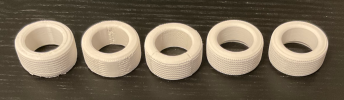

I experimented with printing wheels for the model. Just using regular extrusion printer and printing ABS. Mostly experimenting on direction of the print:
The final results are pretty decent:
