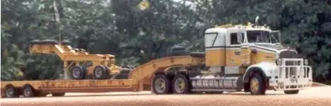

Started making this model about 1987 and took approx 4 yrs before it was finished, had a couple of house moves in that period, so was not able to just keep at it to finish the model.
Used this vehicle as inspiration for the model, tried to do a miniature version of the full sized vehicle, BUT, I failed on that one.
Changed quite a few things compared to the original vehicle so a few minor modifications to the truck.

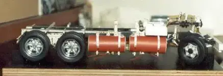

Now the prime mover is only a Highly MODIFIED version of the Monogram 1/16 scale kit Kenworth.
The Dolly and Low Loader are actually Scratchbuilt, the load on the float is only a Bruder kids toy that I chopped around and changed a few bits to make it look a bit more realistic.
I'll post this lot as several posts, as it's photo heavy, first lot is a bunch of photos showing a few things that I did to the Kenworth kit.
Second post will show the complete model painted and assembled.
The kit chassis was black and all other coloured bits added to the chassis, are things that I made and added to it.
Without further ado, have a look and see what you think -------------
38275498sWbybe_ph copy.webp 38275626jXFzCG_ph copy.webp 38275678SFpHBZ_ph copy.webp
38275721EFWhJj_ph copy.webp 38275781nkbNUU_ph copy.webp38275822EEKSmy_ph copy.webp 38275885HwjyAb_ph copy.webp 38275915HmPWBm_ph copy.webp 38275963dTozTR_ph copy.webp

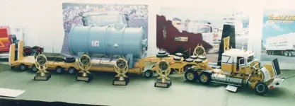

Here's what it looks like today and a photo of a load that I had on it for a long time ------------------
001 sar and load copy.webp12733602_10156582989325271_7210046523630140039_n copy.webp
