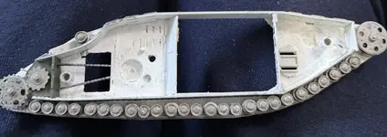

One side is nearly done shame but when you addIMG_6215.webp the extra side panel all that detail inside will be hidden never mind as you can see from the last picture where the side is being glued to it and clampedIMG_6217.webp
