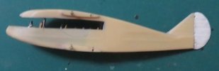

Almost time to put the halves together

Right, we actually have the fuselage halves together
The two sides have come out slightly different sizes, so didn't quite match up, so not the best fit, but a bit of rasping, filling, and sanding and we're there.
Thanks be to slow curing cyano
Also, the re-profiled tail is now on, as you can see
The gap looks worse than it is
