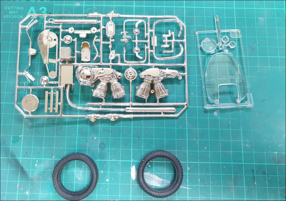

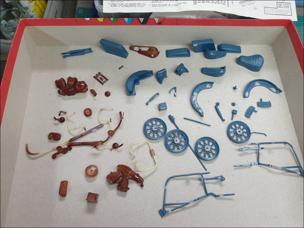

As promised, here are the box contents.
The parts are almost free of flash but there are a lot of ejector pin marks to clean up. There are quite a few chrome parts but I will probably strip off the chrome and repaint. The transparencies are crisply moulded but the visor has some small scratches that will need to be polished out. The "rubber" tyres are virtually flash free:

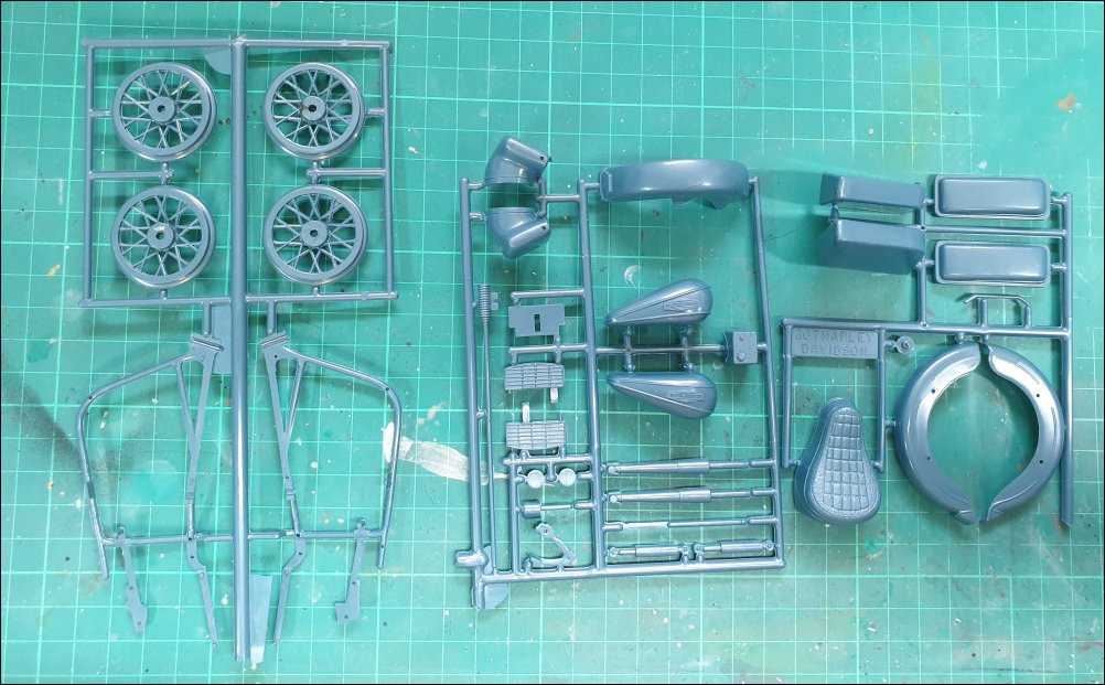

The other parts are moulded in a blue-grey plastic and are almost flash free but there are a lot of seams to clean up:

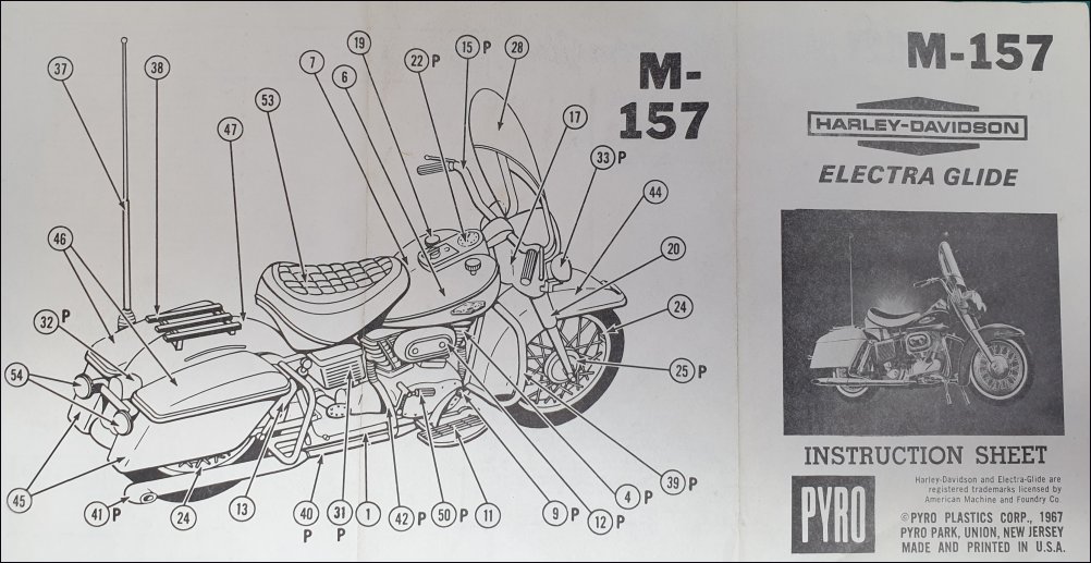

Instruction Leaflet - Side 1 - Exploded Diagram:

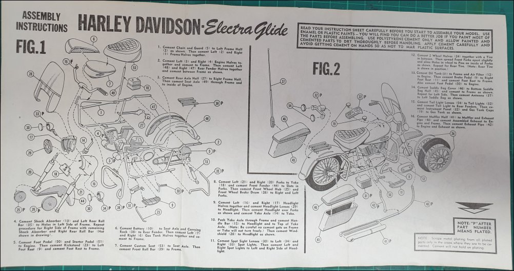

Instruction Leaflet - Side 2 - Detailed Assembly Instructions. These are similar to the old Airfix "locate and cement" style which means you learn what the parts are as you build:
I was disappointed that there are no decals provided by Pyro although considering the age of the kit they may well have been of little use anyway.

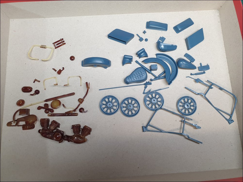

The blue parts were removed from the runners and are ready for cleaning up:

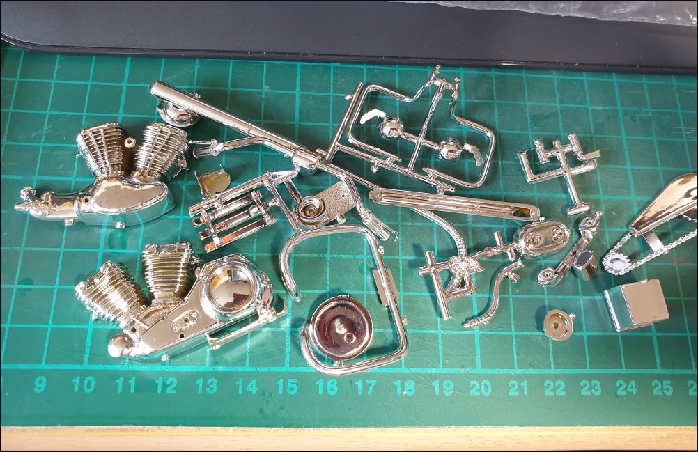

The chrome parts were removed from the runners but no cleaning up yet:

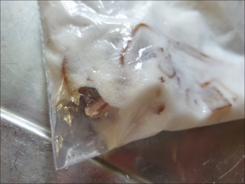

They were then put in a freezer bag of Mr Muscle Oven Cleaner:

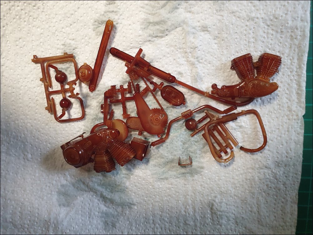

Most of the chrome finish disappeared almost immediately but I left the parts to soak for another hour. I then gave the parts a good rinsing in soapy and then clean water:
Next step will be to clean up all of the parts, fettling their fit as I go.
That is all for now
Off to a good start Dave. Parts look a little translucent after de-chroming, or is that an illusion?
The parts are transluscent, Joe, but there is a brown residue from the "chroming" process that the oven cleaner cannot remove and it looks like they have been stained with tea! I could have scratched it off but decided that will be a waste of time.

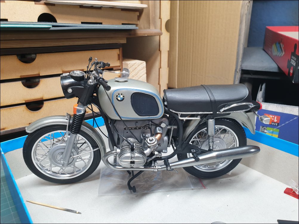

I have been a bit distracted by another motorbike build currently underway - the Airfix (reboxed Heller) 1/8 BMW R-75/5. However, I am very close to finishing it so I will be able to give this Electra Glide build my full attention:

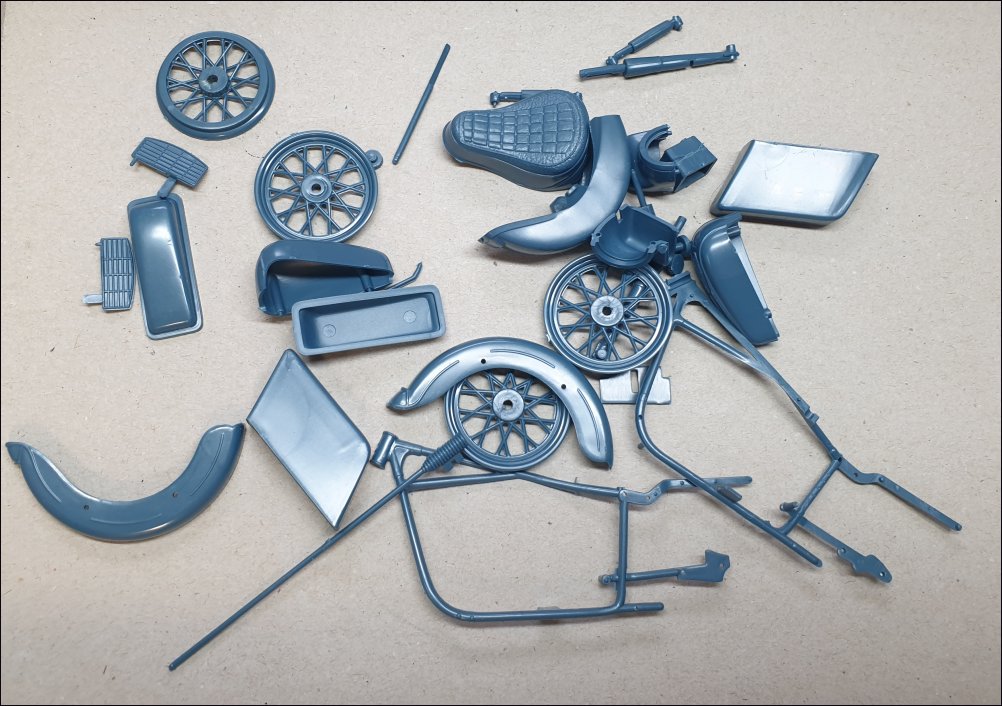

I have spent hours cleaning up all of the Electra Glide parts - excluding the sink marks and ejector pin marks:

Love that BMW. Strange that the plastic of the chromed parts is translucent. Maybe some sort of special plastic to take the chrome???
