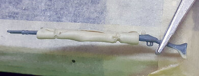

A Bedouin isn't one unless he carries one of their iconic weapons...the North African or Arabian heavily inlaid Snaphaunce Lock Jezail musket. These things were handmade and usually two are never alike. Which means I don't have to worry about being accurate.

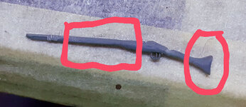

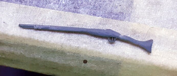

I started with carving out a Mauser rifle...
These rifles were very long at about 54 inches in length. So somewhere along the barrel I have to add an extension of 2 cm. Also the butt needs a bit more work.
I didn't need to show the extension as the rifle was going to be wrapped in a blanket I made with thin Magic Sculpt. Extra left over of the putty went to the butt and flintlock...

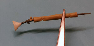

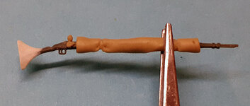

I wasn't satisfied with the Jezails butt stock so I mixed a tiny bead of Magic Sculpt and shaped a larger butt...
Once the putty cured on the butt stock I refined it by sanding and shaping it smooth.
