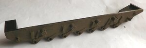

After a long time, cutting, prising twisting - I got all the supports off - and primed to see what it looks like:
Not too bad - the rough bits will be hidden behind the road wheels - the underside is very poor, so I won''t show it..............
