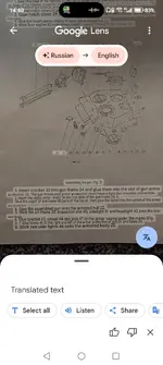

Hardest part is the instructions are in Russian on very yellow paper....... And the translate app mangles it a bit lol

If you take a photo of the instructions, your phone or computer can probably translate to English. I wonder if that motor works.
Google lens does that but it comes out a bit 'not the Kings english like wot I speak' :ROFLMAO:
Screenshot_20261010_144042_com_google_android_googlequicksearchbox_LensExportedAct.webp
And this is one of the best translated pages lol
