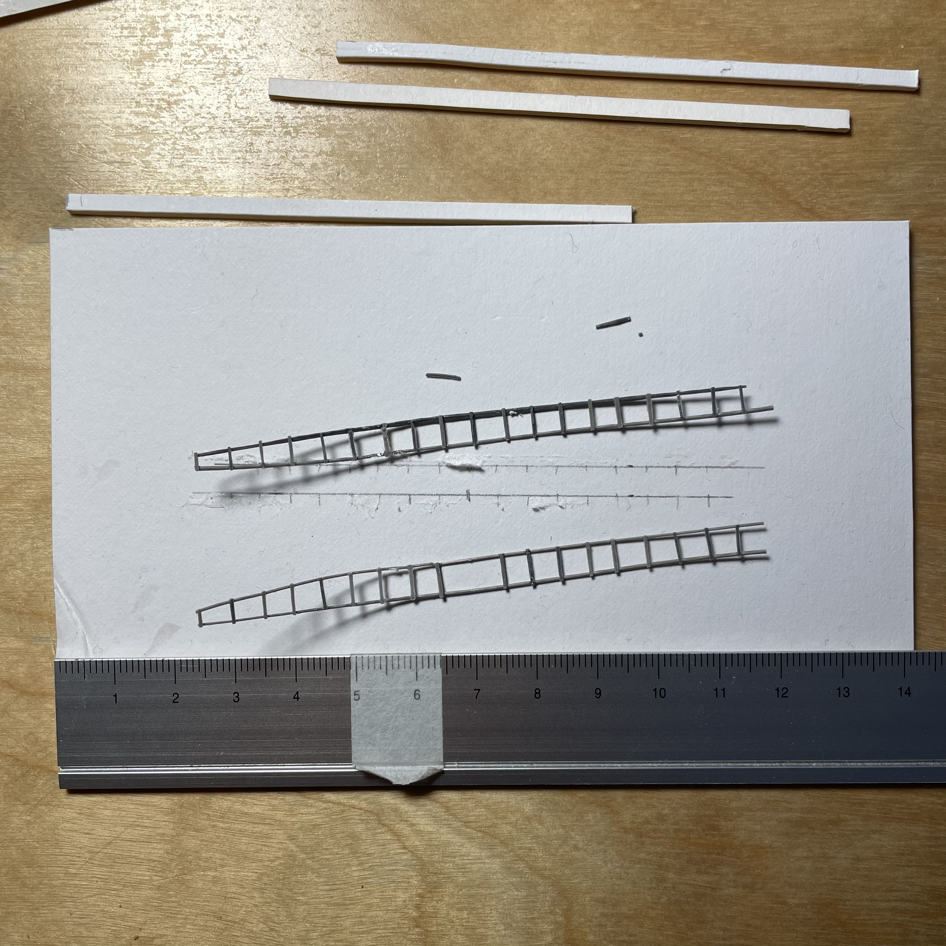

I'm trying to make a scale dirigible from the early 20th C. I have made the balloon, but am having immense trouble with the fuselage due to the tiny scale. I dont know the precise scale but imagine the inflatable part os 150mm long and the fuselage is 100mm long.
I'm working with stretched plastic sprues. These are approx. 0.5mm thick. Maybe a touch less.
So far – I tape/bluetack the length-wise sprues down on a sheet of glass over a paper plan. I then lay the verticals along and underneath the length and glue them with spots of Tamiya thin cement. Then trim them. One made for each side of the fuselage.
Then I need to put the two sides together and glue sprues across the two sides all along their lengths. This is where it goes wrong. There is no strength. The size of the model means the sides might not match perfectly making it hard to mount them upright held down or held together with card strip rigs during manufacture.
The whole thing is very fiddly. Accuracy and consistency is a problem. And the structure warps, is delicate and everything prone to fall apart.
My process is driving me nuts – and I wonder whether anyone here has some ideas how to approach this project? I'm open to a completely new materials and approach.

Working with stretched plastic sprues can present numerous problems as when you stretch the sprue it will still retain the original shape, the sprue during a long stretch will often start cooling along its length resulting in thicker parts of the sprue..
I see you have a rudimentary drawing consisting of length and cross members. And trying to glue on this is going to mean even more problems.
I am going to take it that you are in the UK, so your best shot is to obtain some plastic rod, this can either be square or round and come in lengths over 100mm, with a thickness below 1mm, or if you prefer over 1mm either square or round.
I obtain my rod from a company called EMA Model Supplies in the UK. I have no association with them apart from being a satisfied customer.
Next your drawing, get some clear cellephane either a kit sprue bag or even 'cling film' as used in cooking, tape your drawing down and then tape the clear film over the top of that. This will then give you the base to tape your rod to the clear film, then cement your cross members to the rod using either liquid cement or c/a. And build up yout frame this way, and once dry you can remove the clear film with the frame on and lay another sheet of clear over your drawing again and repeat untill you have all four sides constructed.
I first used this method when scratchbuilding an SBG bridge to go with the newly released Tamiya Churchill in 1980, and still use it today.. HTH.

You're right. I do have some rod. It's .020". I could not get square at the time, perhaps EMA will have it.
My photo is misleading. As it's the one I started trying mount the ready-made sides vertically on.
As you say – I used cellophane and then later sheet glass over my plan to glue together and get what you can see (the two sides). It's a good way.
Combining the two sides remain a stragetic problem though.

I found the square rod at 0.5mm and 0.3mm at your supplier. I'm not sure why I stopped using the rod I had after my prototype. Perhaps as what I could find was just too thick. But the 0.5mm should match perfectly.
Also as you suggest the fact that this material will actually lie straight will be a huge advantage.

Here's the prototype I made a while back with AK Styrene 1mm square rod. It looks crude, but perhaps with the thinner square polystyrene rod and my improving technique, it will get better.
Is this to go inside the balloon where it won't be seen? If so, why not make a box using sheet polystyrene. This would be much stronger and easier to make. You could continue to use strip to make the tapered ends and the ends of your central box section would give you a solid base for the triangles.
I don't know what size your central section is, but it may even be possible to buy square section styrene tube which would only need to be cut to the correct length.
If you need the framework to show through the skin of your balloon, make the central box slightly too small and add ribs using thin strips of styrene.

See post #1, its on the outside, underneath the balloon.... Cheers

Good suggestions, but it’s the fuselage hanging underneath the balloon .
That looks like a good start and can be used as a guide for a better build. I was going to suggest sheet glass, but a lot of modellers do not have that to hand, but clear sheet does just as good. With the EMA rod(s) I would suggest using liquid cement as this will bind the plastic together by melting the surface slightly, c/a only forms a surface join on plastic to plastic and in some cases will actually seperate later.

Ok. Here's my next question. When I made my first prototype with the 1mm square rod, I attempted to cut all the vertical struts to the same length (they weren't) and butt-joint them.
With the next version, using stretch sprue, I decided to lay the vertical under the firmly stretched top and bottom lengths. then drop glue on them (relying on osmosis) , and then trim them. So the effect is a ladder with cross-bars sitting up proud of the sides.
I think the second method is easier, but the first method will look better – if done accurately. But cutting the vertical struts to a conistent length (4.5mm) will be a challenge.
NB. My next version will use 0.5mm square rods.
Any thoughts on this please?
Maybe this is what I need? Dual blade knife
EDIT Apologies if this has all been asked better elsewhere. And now I'm seeing tools for styrene. Like one called The Chopper II, a rig that allows lengths to be cut to the same size.

I made a frame for the early chopper from ply, just marked the length and cut. Normally they cut much smaller lengths with the base size being the longest cut .

I've decided I need one. I think it will speed up this project – at least make it more doable.

OK back to my project . I now have ‘Chopper II’ which works pretty well even at my scale. I’ve laid out a side of the fuselage and come back to one of my difficulties. Holding it all in place whilst I apply cement.
So far tried a very thin strip of tape. Tried a thin track of pritt stick. Tape might work if i get some double-sided? I don’t have that yet. The pritt stick just seemed too strong. I feel i need something low-tack so i can place and move the struts, but also lift the whole thing (delicate) off at the end.
Any other ideas please?
