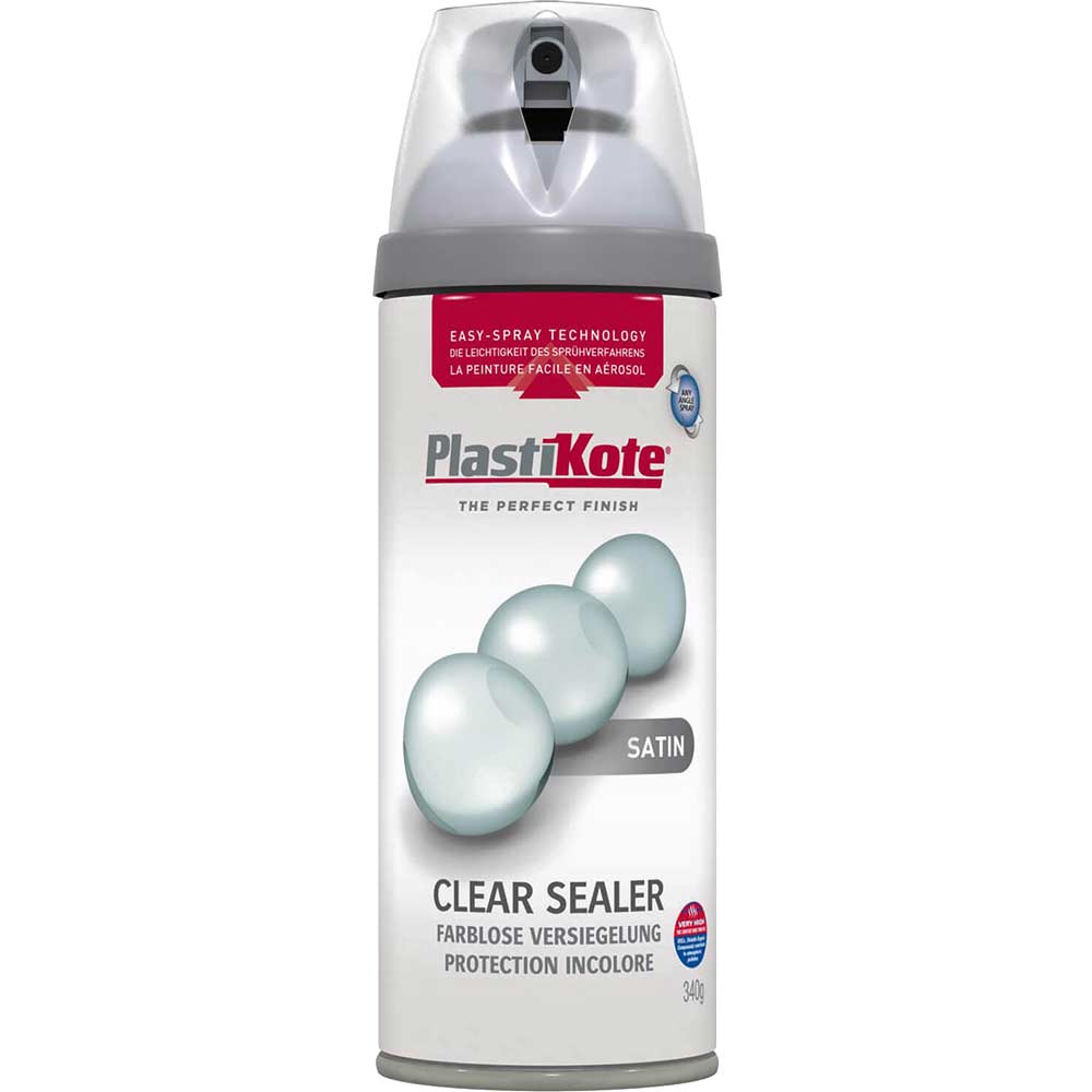

This stuff should do the job equally as good -----------------
It will even work on very old decals, a quick coat of that clear and then you can cut your decals and use them, as that Clear Acyrilic will hold the old decals together very well.
A vast difference in price for quantity though, so better check around for better deals ------------
I would exercise caution in using the plastikote cans for this application.
The majority of rattle cans include volatile solvents to let the product flow through the nozzle and prevent blockages. Such solvents would act as I described earlier, reactivating the chrome paint and dulling the effect.
