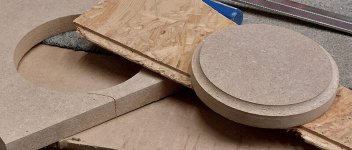

I started by cutting a disk from scrap mdf (18mm, ¾”). I used a router to bevel the edge.

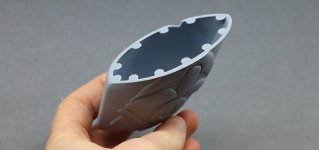

All models are designed hollow,

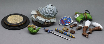

I added all the base colors with the airbrush (vallejo paints), then sprayed a gloss varnish with a spraycan.
Tamiya black panelline wash was used as a pin wash, small stones were painted with a brush.
I added a matt coat with a spraycan, but it turned out satin, so I airbrushed Vallejo matt varnish over it.

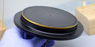

Added a golden line with vallejo brass to the (bottom)base.
I think most of the work is done now, the matt varnish has to dry, next update should be putting it all together...

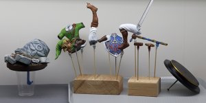

I forgot to mention in the previous post that I also added a gloss varnish and pin wash to the figure-parts (rather subtle)
Next I removed all the parts from the wooden sticks (glued with hot-glue),

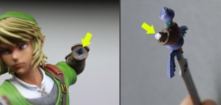

3D printed resin is quite brittle, the most fragile part will be the 'hand with sword',
to make this easy replaceable I drilled a hole and glued a 2mm (5/64") magnet in both the forearm and hand.
So the hand stays in place with a tiny magnet.
