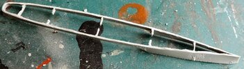

From the stash, I retrieved the Dragon 1/700 USS Buchanan - this has a one piece hull. Normally I would add the deck to stiffen things up, but I wanted to see how I went without.
DSCF3560.JPG Masking tape added along the waterline as a guide. I used 15000 rpm at first, but I could also use 10000 rpm. When using this type of saw you should wear eye protection, as bits fly everywhere. It took about 4-5 minutes to cut the hull - the tool got hand warm, but nothing worse.
This was worst possible case, a small flexible model & first time using this thing. It felt good in the hand, nothing rattles when you shake it. No sharp edges ,there are fixing screws open to view ( and check for tightness ). It vibrates when using the saw, but you'd expect that from a light tool at quite a high speed. With sanding drums & engraving bits not a lot of vibration. DSCF3561.JPG
Initially a bit wobbly, but as I got used to it, and improved - if I had added the deck it would have been easier!
Next, change collets & try a sanding drum to smooth down the waterline & remove burrs
This time, I could use 5000 rpm & the results were good
Final flattening will be on a sheet of emery on a board................
