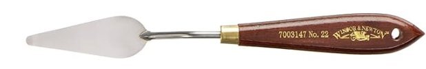

I bought a long handle trowl thingy that is for painting with oils..the trowl bit is diamond shaped like a brick laying trowl but its only about an inch long.....got it in hobby craft for about 3 quid
Thanks Paul!

I also use a small spatula like this for filler where needed. It’s also great for mixing paint in the cup of my airbrush, for ladling out weathering pigments and powders, and many odds and sods tasks.
IMG_2344.jpegLastly, for larger application on groundwork and such I use a small artists palette knife like this. I picked it up for a pound at a boot sale….
Anything bigger I have a bricklayers trowel LOL….
