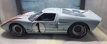

Just fitted the carburettor, fuel pipe a d several tiny accelerator linkages. Made a return spring - now to see if I can fashion a reasonable throttle cable.

Some more progress, was hoping to complete this before the Tamiya GB but still so much to do and going on a weeks cruise so the best laid plans.....
Major problems with the steering. I've glued in position as it's a very clunky design. The steering column was 15 mm too long, the steering rack needs shortening as it gives a toe out stance to the front wheels and the brake cooling pipes were absolute garbage - had to shorten them by 10 mm and put curved sprue inside to stop them collapsing.
Got the interior 95% finished and very happy with the extras I've fitted or scratched.
Painted the black light recesses and window frames, fitted the first headlight cover. Rear clamsheel air scoops , grilles, grille frame and lights fitted.
Finally spent ages making up the fuel and oil lines.

Actually really pleased to be going on a week's cruise as this kit is now fighting back with venom.
Of the 9 oil/fuel lines I made previously I've managed to attach 5 successfully so far.
The windscreen seems to be from a mid 80s Fiat Multipla, much too large and incorrect curvature. A whole day's work means it fits where it touches.
Some photos of it with loosely fitted panels.
