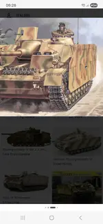

For those of you who like to know the history.
So far I have done this with out any problems ------ I think
