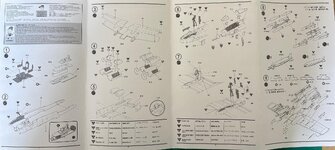

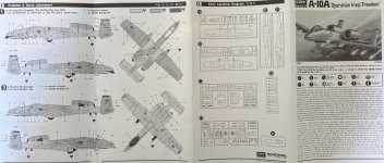

Pulled this one out. Reviews for this kit are mixed, but they almost all agree that the fit isn't great. Not sure which scheme I'll be doing, but as they both use the same camouflage pattern, I can make that decision late in the process. The decals are Academy's in house (very thin) version, so not possibly looking good for that shark mouth option.

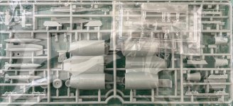

Every sub-assembly so far has needed filler or scraping. I've fixed weights into the forward fuselage half, secured with sprue scraps.
Every bomb and Maverick missile has major ejector marks. The wing fit wasn't too bad, just some filler around the leading edge protrusions (wheel bays), and at the lower inside wing tips.
The engine nacelles didn't line up on both sides, so to make things easier I aligned the inside seams, and put filler on the outer ones. The exhaust sections had horrible seams that will be visible inside the cowlings, so I chopped up a drink straw and used it to create smoother surfaces. It won't be 100% realistic, but certainly better than the alternative.
Cockpit is being painted etc, I'll update when the Warthog airframe is assembled. I might need more sandpaper...
