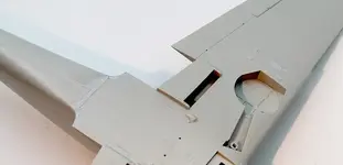

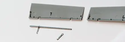

First I'd like to point out that all the hinged parts 'dangle' very loose - which I personally don't like for a static model so I will glue them in a fixed position later on.
The hinge-system is made with PE-hinges which slide over a steel rod.
Left aileron and flap.
Gluing the bottom- and upper-wing parts, aileron and flaps in position.

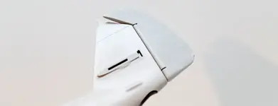

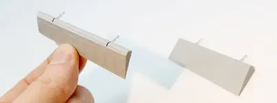

Gluing the elevator(hinges) to the horizontal stabilizer.
-limit 10 images exceeded -

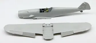

Wing ready and cleaned up
Gluing the wing to the fuselage.
I bit of putty was added in the front and back of the wing connection, this still needs to be sand down when cured.

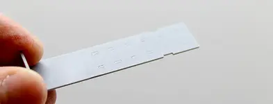

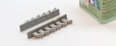

So I found this piece in my scrap-box and marked 12 holes with a scriber-tool.
I used a small Dremel-bit to cut out the holes.
Then the exhaust-pieces were glued to the panel, so now they shouldn't be too difficult to install in the nose.

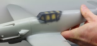

First thing on the list was masking the canopy, I used 18mm Tamiya tape for this.
After all those years the pilot is still waiting in his seat to get air-born, this was an old resin figure from Evilbay.
There was no room between the pilot and the canopy, so I couldn't glue the steel plate behind his head.
I glued the 3 canopy pieces in place with Kristal Klear, the fitting of those was very good.

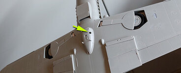

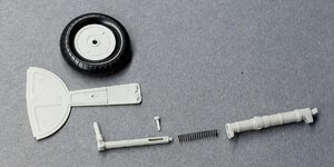

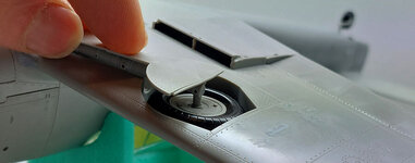

Next is the under carriage, which has a working spring, quite nice but not useful for my model,
If you remember correctly I'm making this model in 'flying' pose, so I need the gear to be 'retracted', those parts are not designed to be retracted as you can see here,
So in the end I just glued the wheels inside the bay with epoxy,
Then covered them up with the bay-doors, I glued some plastic bits inside the 'hinge' hole and also a small disk between each wheel-axle and the bay-door.

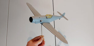

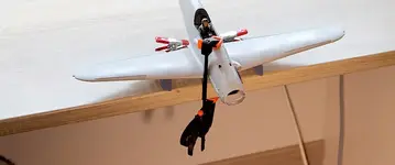

Originally I wanted to 'hang' the model on strings, but I will use a 3mm steel rod/pole instead.
For this I drilled a 3mm hole in the belly, angled
And that will give a flying pose like this, still need to cut a 3mm steel rod (wooden stick at the moment)
I sprayed a dark grey for the inside of the cockpit (mix black/white Vallejo primer),
Then I tried to cover all the cavities with black Vallejo primer,
Then I covered the rest of the model with a light mist (still black Vallejo primer),
first time I'm not going full black on the primer coat, so hope this won't be an issue for the next stages.

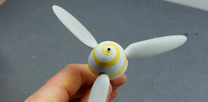

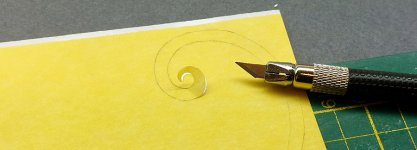

This evening I did some work on the spiral spinner - I found some spiral mask shapes on Google images and printed them in a few different sizes.
Then I traced the drawing with a pencil onto a sheet of 'AK Masking Tape A4' (AK8211).
Next I've carefully cut the spiral with a small hobby knife, the curves made it a bit of a challenge.

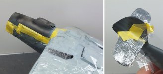

The mask was then added to the spinner, the spinner was previously sprayed with white primer (Vallejo).
A lot of images tend to show black spinners/props, but most likely this was more of a 'black-green' (RLM70).
I took a middle ground and mixed 'RLM70' with 'black' as I prefer the look of a dark color.
This is the result after removing the mask, the spiral curve wasn't perfectly cut with the knife but I'm still very pleased with it.

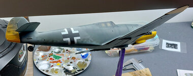

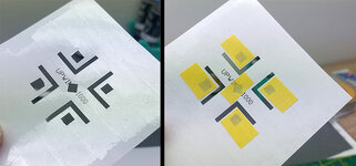

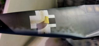

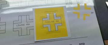

Got a few hours yesterday so tried to make a masking set with the AK (A4) adhesive...
The decals from the kit are nice, but at this scale I prefer to airbrush to avoid silvering issues. Also the fuselage crosses seem to be like 2mm too wide.
I first drew out the crosses in NanoCad (free), the crosses had a certain size (1000mm, 950mm, 900mm), then they divided the lines simply in percentages (for example [25%-25%-25%-25%] and so on).
I laminated the print and placed pieces of AK masking tape on top, cut them out with a small blade. In this large scale it's easier to cut but the large piece of tape is a bit awkward to work with, the fine crosses were too fragile and got distorted, so I'll have to make new ones from paper.

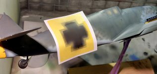

For the fuselage a 900mm cross was used, about 37.5mm in 1/24. I sprayed the inside black (Vallejo)
Next the black cross is covered with an inside mask,
Then the outer sides are sprayed with white (Vallejo),
I carefully removed the mask, as I'll have to reuse it for the other side,
No paint got damaged by the masking, so I'm very pleased with the result so far. I need to make another set for the top- and underwing... The rudder also got some green paint based on the reference picture.

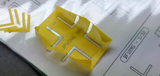

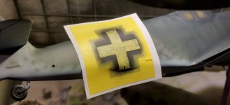

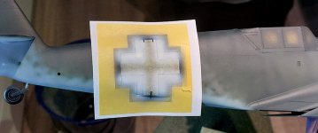

Last time I screwed up the upper-wing mask, so I reprinted the cross on paper and placed transparent adhesive tape on top.
Then I've cut it with a knife, also added 5 more holes - these are covered with Tamiya tape...
Next the mask was put in place and hold down with the Tamiya tape. I did use tweezers to hold down the middle section during airbrushing though.
I sprayed a thinned white (Vallejo) and the mask worked great, used the same mask for the other side as well.

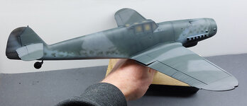

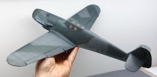

Today I sprayed the winter camouflage with white (Vallejo), quite heavily diluted.
I tried to use the original photo as a reference, but I struggled with tip-drying so had to keep up a fast pace.
Had to 'guess' the pattern on the other side of the fuselage and wings,
