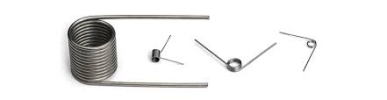

Wondering if you've thought about a tiny 'torsion spring' they seem to be used for a lot of things nowadays and you might be able to get one in a very low 'weight' which would just be fitted to the axle?
NO can do Gerry very good idea thanks but the axle bar is all covered in so elestic may be the way or as i said to Tim a light strechy spring from a pen maybe my best bet as as the micro servo's are not that strong

I might well be wrong, but I'm thinking that a pen spring might be too strong (even compressing, rather than stretching) as they're a fairly strong wire and wound rather 'tight' - you may find that you might have to stretch and cut one to reduce the number of coils to 'soften' it
