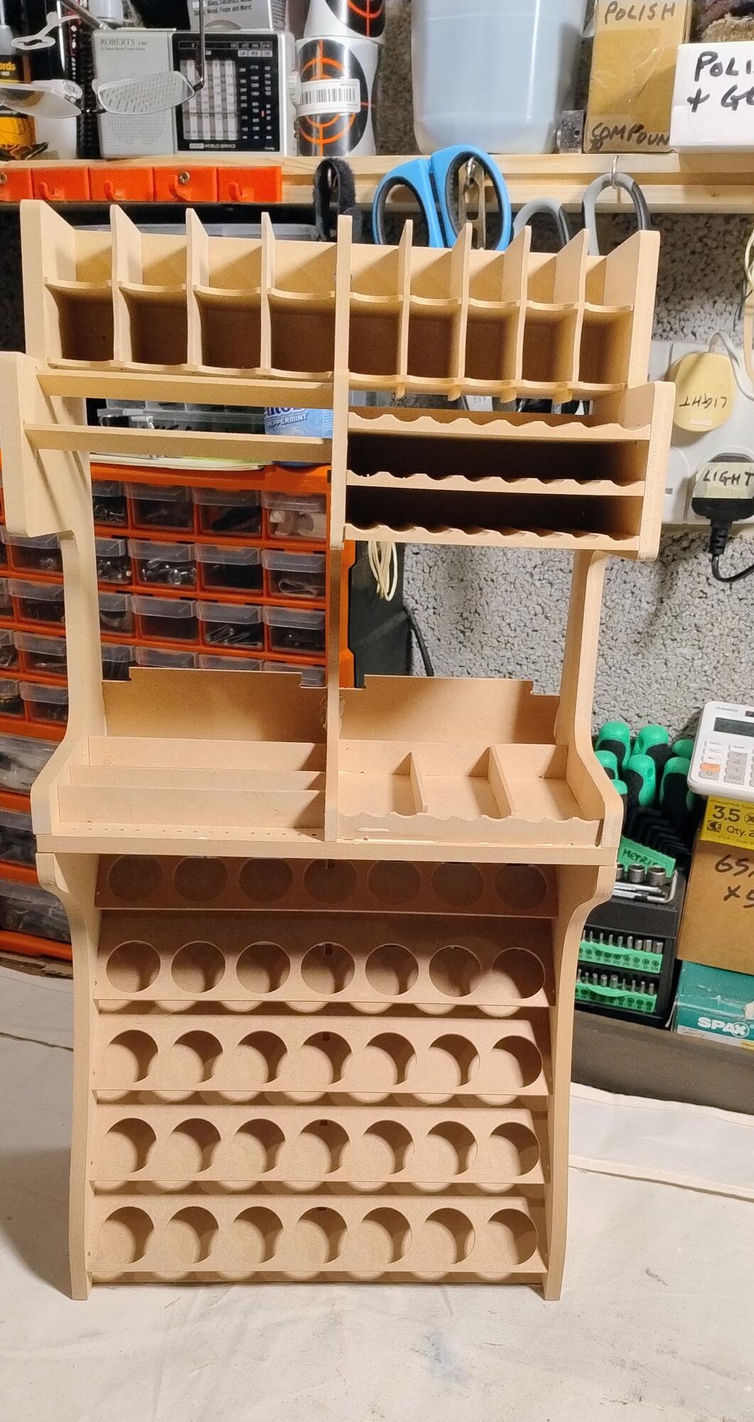

As you may have read on other threads I have just bought a new model making/paint stand.
From Bucasso, looks nice, well priced, well made, etc, etc.
Its one of these, comes in two section, top half and bottom half, they can be joined or separate....see pic:
It arrived, I assembled it, I painted it, all good. At no point had I yet put any of my paints in it.

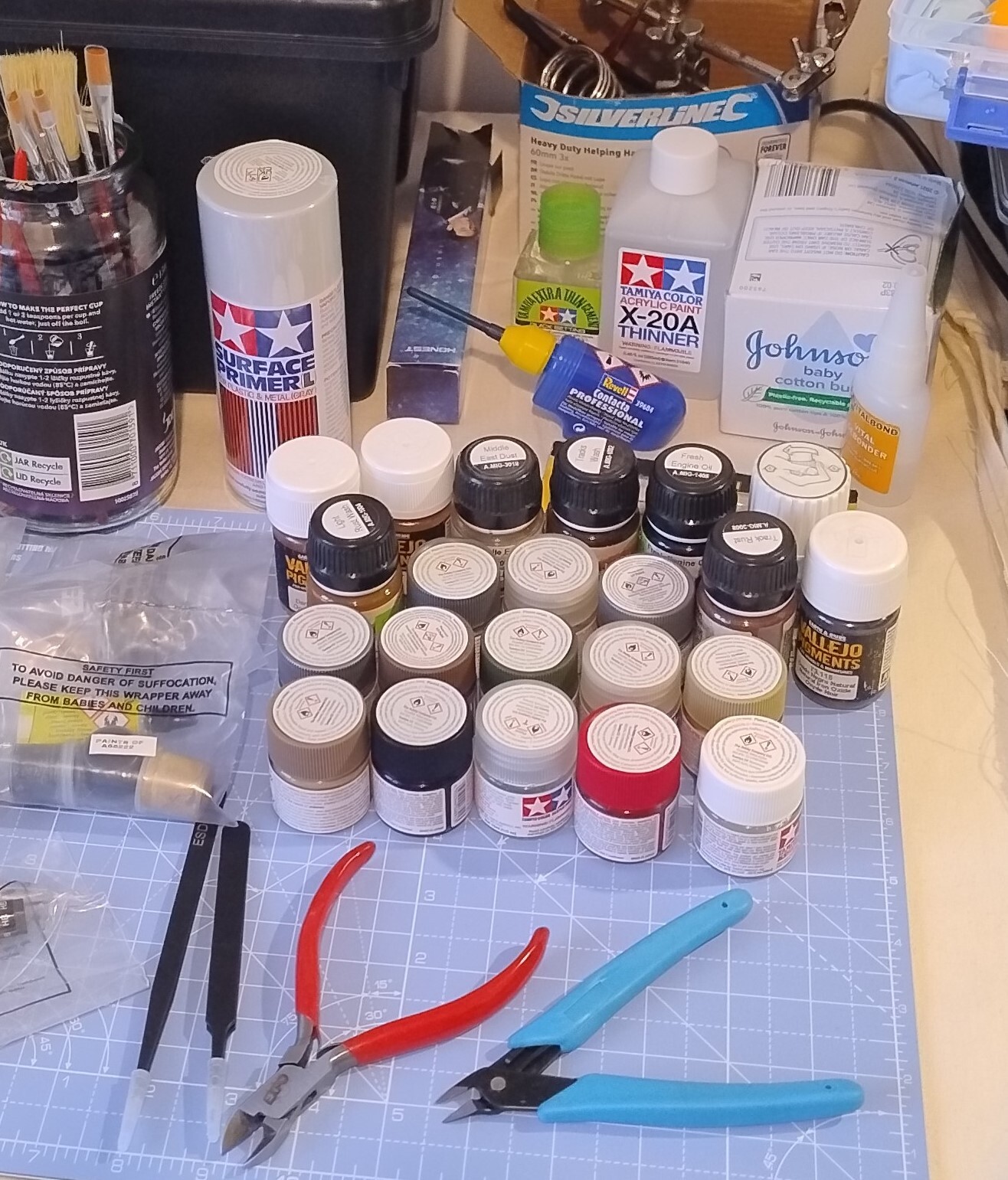

I have Tamiya jars/bottles, and AMMO, Vellajo and MG washes, panel liners, etc. See old pic below, although I have a few more than this now, about 25-28 so far. These are all 35mm in diameter, so none of them fit the 32mm holes.

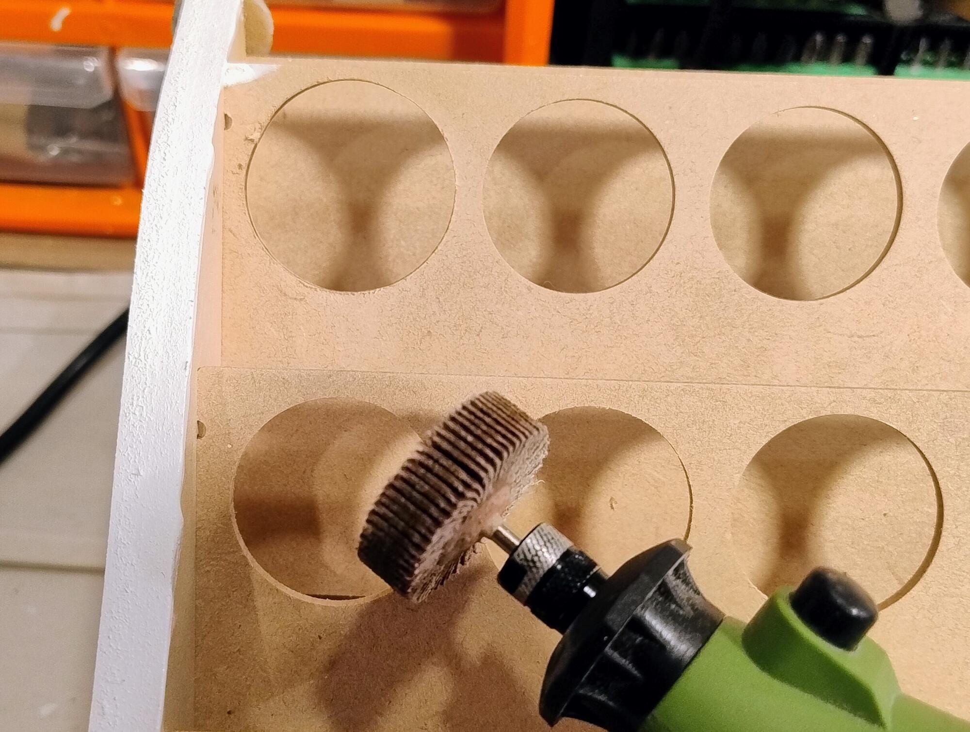

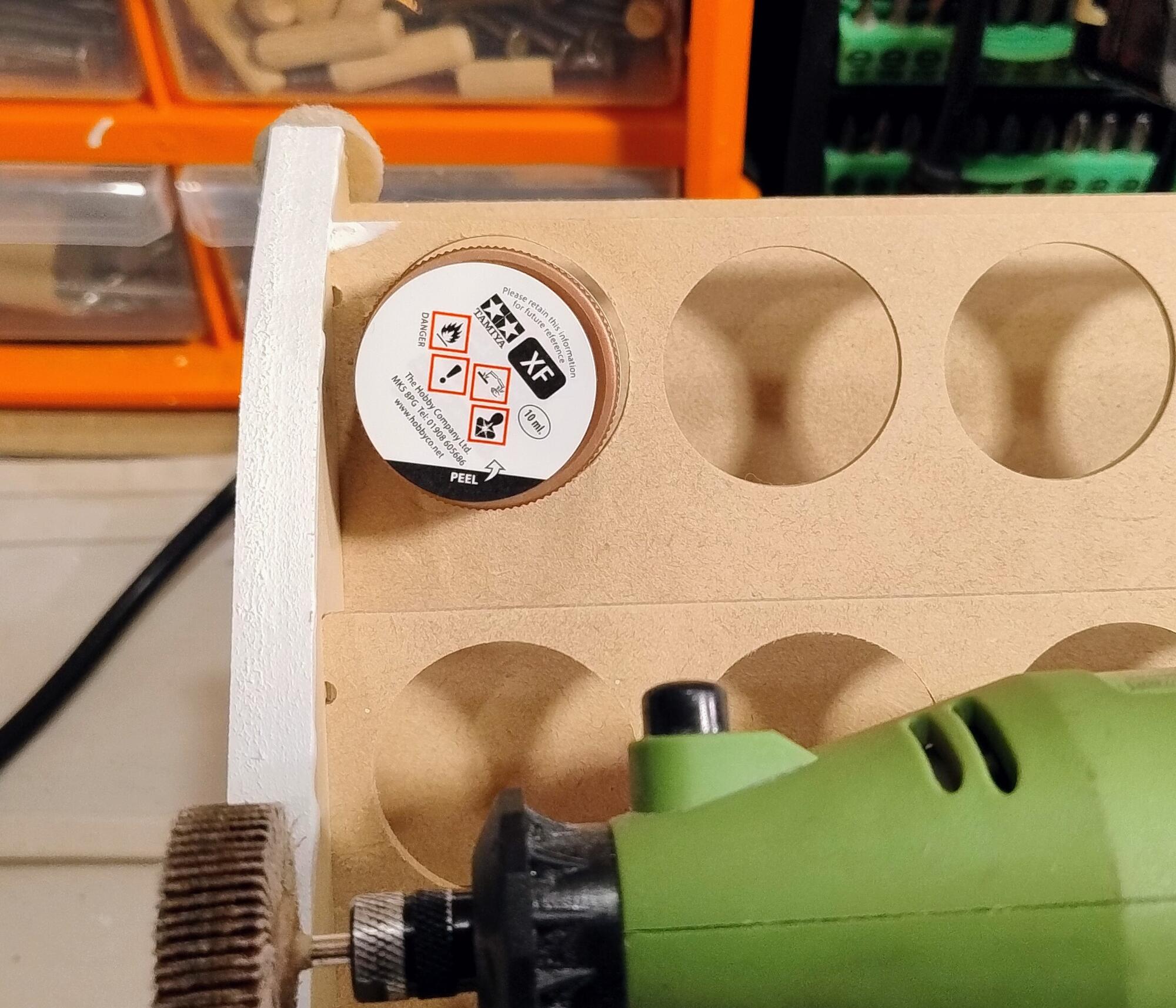

So had a look to see if I could make these holes any bigger.
Looked at using a Forster Bit, but as the holes are already cut, nowt for the centre of the Forster bit to centre on, so no good.
Looked at a hole saw bit, but again, needs summit to centre on, tried it anyway and it just wobbled about like a wobbly thing from Wobblesville!
Lastly, thought, hmm, I must have some sort of sanding disc small enough, and looked in my Dremel (clone) box, and yes, theres was a sanding bit just the right size.
So I could therefore effectively ream out each hole to the correct size.
See very short Youtube clip - see linky
Took about 30-45 seconds to do each one, but there were 35 of them, and I had to keep stopping every now and again to let the dremel cool off as it was getting bloody hot!
So now have a paint stand that actually holds my paint, but.... I've already filled it up, so will need another one very soon! 😂😂😂

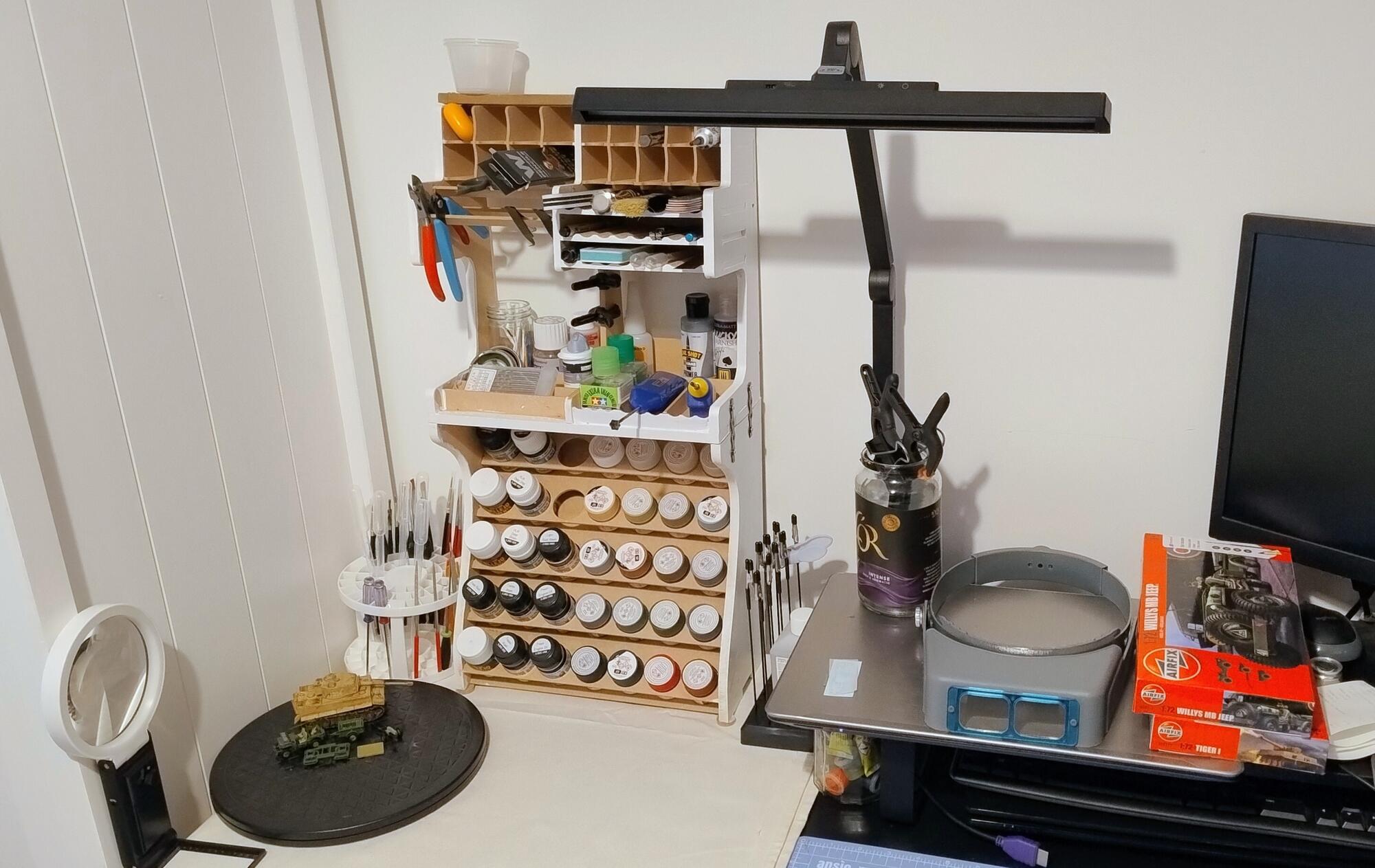

Result....
