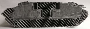

I had to slice this model down the middle, so the track detail will print at a best orientation - the diagonal structures are the support material, which should remove easily ( ! ) The mating faces will need grinding/sanding to give the best fit with the other side.
I've been tweaking printer setting a bit, dropping the temperatures slightly to decrease the amount of stringing - it's resulted in one of the cleanest prints so far.....................
