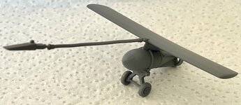

The kit is the basic Hasegawa Me262A-1a with extra parts. The SC1000 bomb and parasol wing structure is cast in resin, with a white metal tow bar and trolley components. There is a separate instruction sheet for the differences from the main kit:
Click image for larger version  Name:	IMG_2085.jpg Views:	0 Size:	660.4 KB ID:	1251741
The main difference from the usual Me262, apart from the glide bomb, is the inclusion of RATO rockets on the underside. These are cast in metal.
I started this about a week ago. The cockpit is a standard affair, the only difference being the decals are renumbered according to the alternative instructions. I spent some time studying the alternative instructions to ensure I drilled the necessary holes for the tow boom and the RATO rockets.
Construction of the 262 is normal other than the holes and RATO rockets. There were a few gaps that required filling, for which I used Vallejo plastic and Tamiya putty, particularly for the engine nacelles.
I found working with the resin quite easy, using a Trumpeter saw set to remove the casting blocks and wetting the surface to prevent dust when sanding. The resin bomb and trolley were assembled, and the parasol wing was cleaned up. These were all primed.
Once dry I began assembly of the SC1000 bomb tail fins. These are thin metal parts which fit into very shallow recesses in the bomb's tail.
I filled some pock marks in the bombs nose cone with Tamiya putty. You might notice I used styrene strip for the tail fin ring. The provided metal strip just would not hold its shape, and manipulating the ring put pressure on the fragile fins which broke off or bent. After three attempts I gave up and tried this solution.
Once dry I found the replacement ring had also deformed, and one of the fins had snapped off again. I gave up on the metal parts, the rear of the bomb was heavily marked by the damage.
So I turned to another solution. I don't have photos of it, but I rummaged through an Italeri Ju88 kit and found an SC1000. I cut the tail off the resin bomb at the immediate rear of the pylon, and grafted the rear of the plastic bomb on to it. It has improved the look of the bomb. I'll update with the latest photos tomorrow, the whole thing has been primed and is currently drying.
