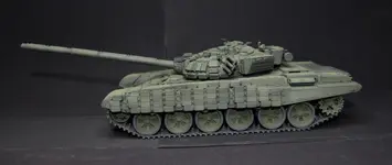

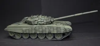

Pushed the T-72 into the spray booth and chucked some green stuff at it. Using a mixture of Tamiya paints I put down a dark base colour then mixed in buff to make highlights to add some interest to the ERA blocks….

A little more progress with the T-72.
The tracks were sprayed using a homemade mixture and then fitted. I used some copper wire to hold them together rather than the plastic pins supplied due to slight tension on them. This meant drilling out a couple of links, but that wasn’t a big deal.
The rubber was picked out on the wheels also…..
