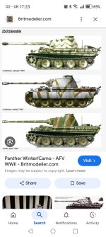

Hi. I am looking to paint my Panther in eastern front winter camouflage. I have found a couple of examples of models on YouTube but not the exact colour used. Just a matt white or an off white? Any ideas? I believe the paint was just sprayed on for winter and then scrubbed off in spring so I'm thinking brilliant gloss white is not the way to go. I have found an pic of an actual one in white with what looks to be a grey zigzag on it which I might give a go once the white is on. Any advice is welcome.
German paint was designed to applied 'in the field' by what ever means was at hand........ In repair areas it was sprayed on.... By the troops it was by brush, rags even sweeping brush........ Also the paint came as a paste that was diluted by what ever was at hand..., didnt matter if it was river water, petrol or high octane aviation fuel!
So actual precise colour is impossible lol......... Id go for an off white
Hope you share with us as you progress
Yes thanks. A finish that looks like it was applied by a sweeping brush will suite my airbrushing skills no end. Not sure if I can attach this pic but its the look I am going for and then maybe the grey zigzag. Blast some sooty black out through the vents, exhausts and gun muzzle and I hope it will look pretty good.
