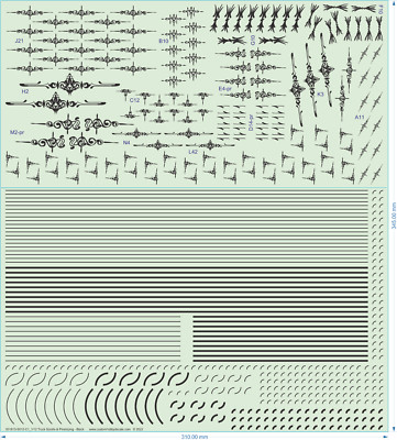

Hi Lee, the pinstriping on my models, is done with an old XP windows computer using CorelDraw to do the artwork, then I use an ALPS MD-5500 printer to print the artwork onto a clear decal sheet. Then just cut the bits of that decal sheet to whatever sizes/shapes I want, then apply the waterslide decals to the models.
Can NOT help you with a Cricut at all.
To do the louvers/flutes on the bonnet, the shape should be a strip running down the louvers/flute, just a bit narrower than the louvers/flute and with a rounded top and bottom on that stripe.
Hope that makes sence, as that is how any flutes were originally hand painted, they DID NOT have square top or bottom on the louvers/flutes at all.
Good luck with what you come up with though, it will make the bonnet "POP" when you do the lovers/flutes.
Oh, if you are after pinstriping as a waterslade decal, look on Ebay for waterslide decals, you can get sheets of decals with plenty of different thickness stripes, just look for Truck Decals.
DO NOT USE ACRYLIC/VINYL DECALS, as they are far to thick for anything other than a full sized 'billy cart'.
Click the link below and just keep scolling down, check out the range of colours and widths of the striping that are available.

Have you had a look at Ebay for truck pinstiping decal sheets?
Or even pinstiping for trains, as they go right down to stipes as thin as a 1/4 of a millimeter.
Looks like posting second lot of Ebay is called a ---- pardon our interuption -------------- so just click on those words for the train decal sheet.
Oh, all different colours are avilable in either the truck pinstriping or the train pinstriping as well.
Very easy to use as well ------------
