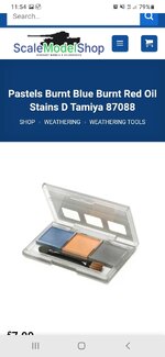

Anyone got any good tips for painting the exhausts? to get a realistic look, eg: stained, heat, etc?

To get the blue colouring on an exhaust most people use one of the tamiya weathering kits.....one has all the right shades but its one of those jobs that needs practice to get right
Been watching loads of YT vids on exhaust colouring. Just to make it harder for myself .... I will be brush painting, whereas all the YT vids seem to show air brushing, Yikes!

No........the blueing thing......tamiya do these little sets with colours in them which you apply with a little sponge on a stick and sort of polish it in......different sets for different things.....and one has the right colours for exhaust blueing........they are not expensive and last forever
I bet the bossfeller has them in the shop......failing that hobbycraft does them
