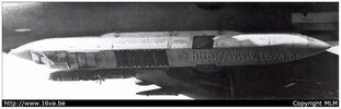

Into the final furlong now with this build. The final stage always seems to take forever as theres so many tiny little details to add . Referring back to the dilemma mentioned earlier , the KKR1 reconnaissance pod on the centreline is the problem. The kit one was very sparsely detailed , ive already added the camera covers at the front but after finding better references realised theres a massive detail underneath missing. The pod has a raft of flare chutes for night time photography ( 152 in all , in rows of seven and eight)
Not being able to find any decal for this meant i had to improvise and the only way i could attempt it was to add the dots freehand with a pen . After about ten attempts ive ended up with this , a bit rubbish but im not messing about any more , its close enough and no ones going to see it underneath anyway. C9110C9C-4834-4700-862F-BFA84D33CB62.jpeg6563ECE6-52AE-4BE7-A8E8-5A3FCC38C992.jpegD239D31D-2C4E-4B8F-B145-4E7CA401D440.jpegF0D2FA59-595D-4DE2-898F-9BD0271C08AD.jpeg5E5CFE61-7DF9-444D-8ABB-867D113E9546.jpeg
