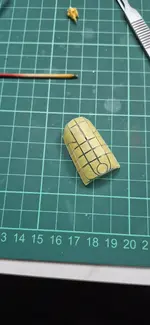

A little more progress on the JU88
The wings thankfully can slide on when finished so it should hopefully aid the painting process. canopies were then masked up and temporarily fitted ready for paint.
Masking went reasonably well considering the moldings on the clears weren't as established as newer kits are. I also had a front viewing window below the nose glass that was missing from the kit, I'd forgotten to photo what I did but Imanaged to make a glass from a medicine cup I had lying around. turns out the curve is near perfect for this part :cool:. It's always been an issue for me the canopy masking, it never seems to go well and I end up with some paint travel underneath, Fingers crossed on this one!
