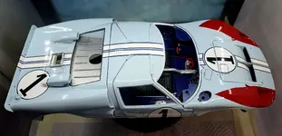

Well the roof and rear spoiler decals completely disintegrated when being masked up to paint the vents etc. So after whole week of masking, matching colours and more touching up it looks acceptable. So cleaning the spray booth and filters I am prepping for clearcoat.
Wheels have received a light wash and dry brushing with a matt coat on the tyres.

I can't see the defects in the photos, you should be very happy with the work you have done. Looking forward to seeing the GT40 shine :cool:

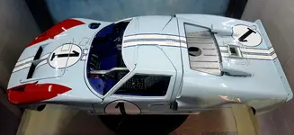

Eventually applied the cleacoat, seems to have disguised the rough decals and hand painted stripes. There's a few dirt inclusions but inclined to leave them as its a race not a show car.
Some piccies with the panels loosely fitted. 5 days to fully cured then assembly can begin. 😀
