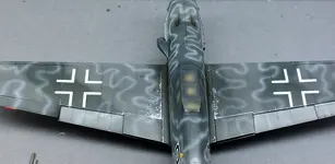

Today sprayed the crosses for the under-wing, I think this will be the last bit of masking for this model.
Same as the fuselage I sprayed the inside black (vallejo),
Then added more masking to cover the black and sprayed white for the corners (vallejo),
All the masking is done now, I will use the kit decals for the smaller details...

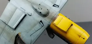

This week I added a satin varnish (vallejo) and started some weathering.
I used acrylics (with a lot of thinner) to speed things up.
Fuel spilled on the belly tank, gun smoke and chipping on the propeller...
The arctic aircraft seem to have a lot of dark exhaust stains due to cold engine starts and synthetic fuel (this is another plane from the same group).
I tried to replicate the effect with a mix of black and dark brown, not yet sure if I under- or overdid it, it depends a bit on the lighting.
I also added a bit of chipping (vallejo aluminium) with a fine brush, tried to restrict it close to the cockpit.
For the underside I mostly added streaks and a bit of dirt on the landing struts.
The oil streaks are a mix of vallejo gloss and black/dark brown, that way it looks shiny and fresh.
Still some small things to do like the antenna-mast and nav-lights etc...
Thanks for watching & cheers
Beautiful work steven , the paintwork and weathering are unbelievable . Shame about the decals but it be looks like you got it sorted in the end . This is going to be a stunning model , cheers tony
