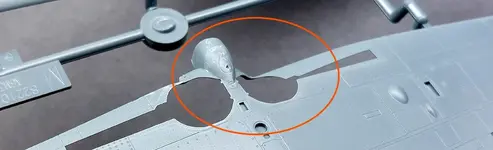

Unfortunately I noticed a bend in the lower wing, hopefully I can get that stretched out again.

Great choice. Those Eduard kits are real good value. That fault on the wing is annoying. I'm sure Eduard would provide a replacement.
Well I never returned a kit to be honest - I guess it would take a while to get the replacement kit, so I'll try to get it to work nonetheless.

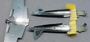

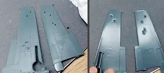

I started adding battle damage to the fuselage halves with the tip of a fine blade. I would like to give the impression that this plane is still barely flying, so it’s riddled with bullet holes or shrapnel. I’m planning to make the rudder and elevator fabric torn up as well. (I avoided added holes to the fuel-tank locations as these planes didn't have self sealing tanks, so they went up in flames instantly...)
On the inside I removed a tiny bit of plastic to get thinner sides,

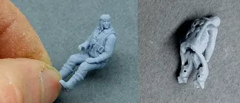

For the pilot I used a 3d RAF figure I bought a while ago, I digitally adjusted his head somewhat to make him look more Japanese (hat with long sides, no earmuffs etc) and also scaled the figure down to about 5 feet 8,11” as these pilots were less tall on average.
Then I made a 3d print and tried to put him inside the cockpit. This took a lot of trial and error but after cutting his legs and bottom I got him in,

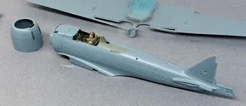

Dry test-fit with the canopy parts in place.

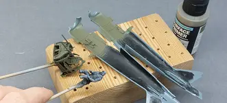

The pilot was then primed in black and white - fuselage got some green and black primer,
Added an interior green, then locally a gloss black primer + aluminium (vallejo),
I tried to add a green/blue filter over the aluminium as they added some sort of anti-corrosion paint in certain places, doesn’t look right but it’s mostly hidden so I’m not going to waste more time on it.

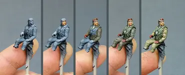

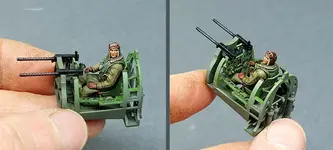

Life is getting in the way again, but at least I've managed to get the pilot and cockpit done.
Some progress pictures of the pilot, I had a hard time with this one - messed up the eyes a few times etc.

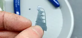

I glued the pilot with super glue (gel) - to save time I painted the instrument gauges instead of using decals.
The fuselage halves were glued together, then from the bottom the cockpit is inserted into the fuselage.
That's all so far, I think the bend lower-wing is going to give me a hard time, it takes quite a lot of force to manipulate.

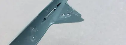

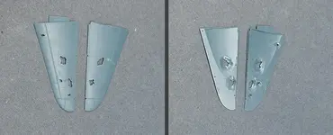

I Added some more damage to the nicely molded kit parts, left-side of the horizontal stabilizer,
Also on the right wing,

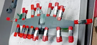

The wing is now glued together as well.

It was a bit of a struggle but after forcing it in place during the wing glue-up it turned out OK eventually (y)
Since it's another 'in flight' model I added a block of wood inside the fuselage behind the pilot for the vertical rod. Although that space is quite detailed you can't really see much of the inside - So I added some black paint to the wood and glued it in place with super-glue.
After some struggle with the bend lower-wing the plane is now all glued together.
